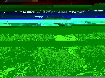

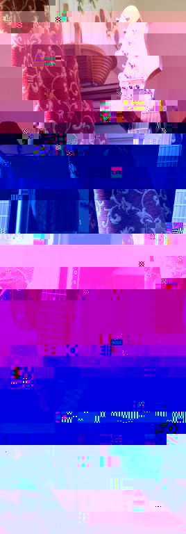

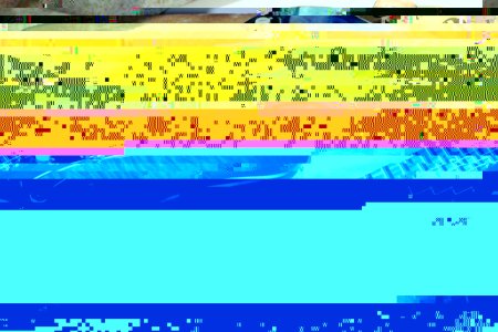

Hi All,
Here are some pictures of my latest build.  Specs are:
Body:
7/8 S-style solid mahogany body with Unique Choice flame maple top - very heavy!
Blue dye with masked binding, black gloss back, contoured heel
Original floyd - chrome - with big brass block
Kinman Extra Vintage Astound humbucker (bridge)
Kinman Impersonator 54 (neck)
Side 7/8" jack with electrosocket
500k Volume, 500k no-load tone, 3-way and push pull coil tap on volume
Neck:
Raw Canary wood wizard profile sanded with 2400 grit micro-mesh - super smooth!
Pau Ferro 10-16" compound fingerboard
SS6100 fret - stainless steel polished with micro-mesh (up to 12000 grit)
Gotoh machine heads
I am loving this new build - these Kinmans are superb and the neck is my best yet - slim, super-smooth and action down at around 2.5-3/64" at the 24th fret.
Pictures below:

Nice! You must be very pleased! That thing's gotta play/sound like a dream!
Yep - love it.  Its my 3rd full build and zeroed-in on my best specs ... and I vaguely know what I'm doing now  :icon_jokercolor:
In terms of playability, the 24.75" scale length, jumbo SS frets and smooth canary/pau ferro neck makes it super fast and comfortable.  I have quite small hands so it is noticeably easier for me than my other  standard-thin strat-scale necks.  Also, really impressed that I can get the action even lower (2/64" at 24th fret) but have raised it a fraction to remove any last bits of buzz.
The Kinmans are amazing too - I have lots of Kinman pups but these 54s are the bee's-knees they really are.  The humbucker suits me well as I tend to play single coils in the bridge and this Extra Vintage is kinda half way between a s/c and a humbucker - it is much more open and clear sounding that my Bareknuckle Cold Sweat (in an Ibanez 2820).
