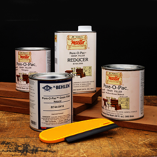

If you want to fill the grain, and you should, don't use a tinted filler on the zebra. It tends to hide what makes zebra attractive and make it unremarkable. So, use a clear filler. Also, don't use the Colortone stuff from StewMac; it's kukka. It's so thin, it takes a million coats to have any effect. You want Behlen's stuff, which you can get here and there, although it's tough to find on the street outside of specialty woodworker supply stores.

But I can't buy the stuff you have mentioned for filling the grain.
I'm in Sydney, Australia & No one will ship this (Hazardous) stuff to Down-Under.
Can't seem to find anything similar to this, down here either.
Now NOT sure what to use now as you said Not to use StewMac Timber Mate Filler (which I could get posted) Not hazadous
I would like a clear grain filler…………Any Help or idea's ?
