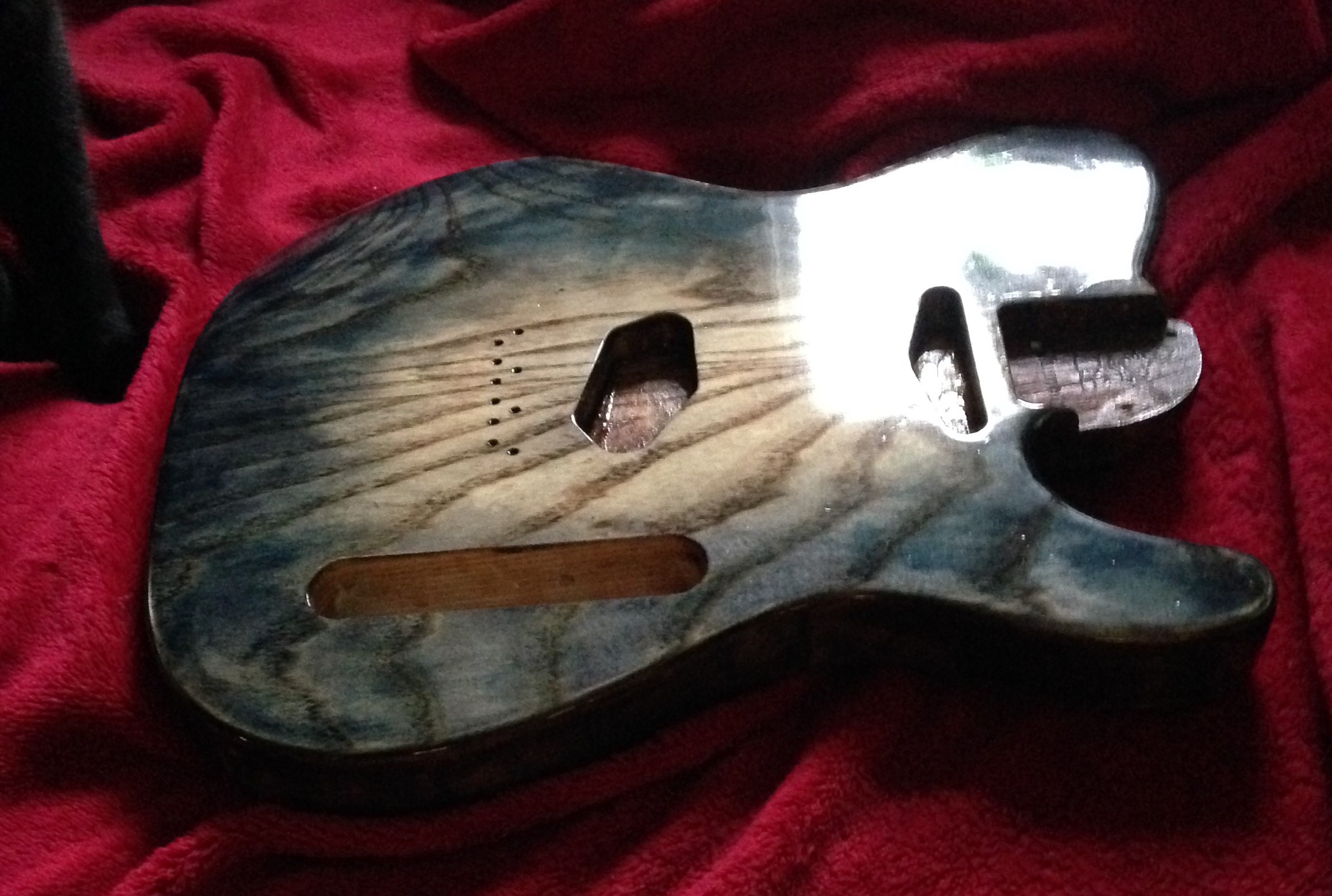

I've only built one guitar to date (with another body and neck on order).  Like you, I went with a swamp ash body, but a roasted maple vs non roasted maple neck.
I stained, sealed, and then used TruOil for the finish.  I'm guessing it's similar to what you referenced.  I'm guessing their "high build oil" would equate to a glossier finish.  I noticed on my project, if you only go with a few coats, you're getting more of a matte finish.  I went with A LOT of coats because of LOTS of screw ups.  The more coats, the glossier it got.
I learned to apply about 50% Naptha to thin out the oil, and this gave it a really wet look and very smooth as well.
Just a couple of coats...
Some more coats...
And finished....
