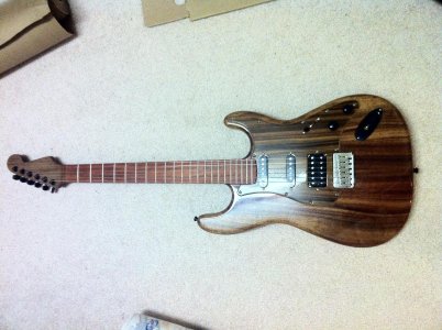

I need to get a real camera, or at least learn to take better pics on an I-phone.
That's a Pau Ferro neck and the body is koa over chambered mahogany (koa bodies weren't available.) The neck came with a slight back-bow...freaked me out at first but I just loosened the truss rod and over-tightened the strings and it pulled out of it. Now it has the best action I've ever played!
I have this crazy theory that Pau Ferro is the perfect neck wood: no finish required, looks like rosewood, feels like ebony, sounds like maple!
I used a Bare Knuckles Stormy Monday for the bridge pup, figured even a weak HB is stronger than a bridge single coil pup. It sounds great to me at least!
I definitely think you'll be happy with the wood choices you're considering.
The trick to better phone camera shots is light. Indoor shots almost never look good. Too noisy. Need to get outside. Even if it's cloudy, the light is better.

ATAN2, good feedback thanks. And get some more photos of your guitar, we like that sort of stuff on here. Try limiting the size to 1024 * 768 so they show up a little easier. Is that a transparent pickguard you have on there ?
