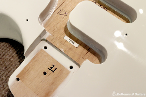

Have a Warmoth modern strat neck, 25.5" with standard 4-bolt mount. I'm curious if this would be compatible with a PRS Silver Sky SE body. I see these bodies are now available as parts and come in cool colors. Anyone tried this yet?

A Warmoth is based on vintage Fender specs and a 21 fret neck, a 22 fret version has a fretboard overhang. A PRS Silver Sky has a full 22 fret neck where the neck shaft and fingerboard are flush with each other and no overhang. The neck pocket shapes are different and one will not fit or intonate with the other.

Thank you for pointing out the 21 vs 22 fret difference and location of the 22nd fret on the PRS Silver Sky. I do agree on the high likelihood of intonation issues even if the neck pocket fits. Going to stay away from this 'experiment' for now! Thanks again!

The neck heel for the Silver Sky and SE, like most things PRS, is proprietary. Not particularly original, but proprietary.
