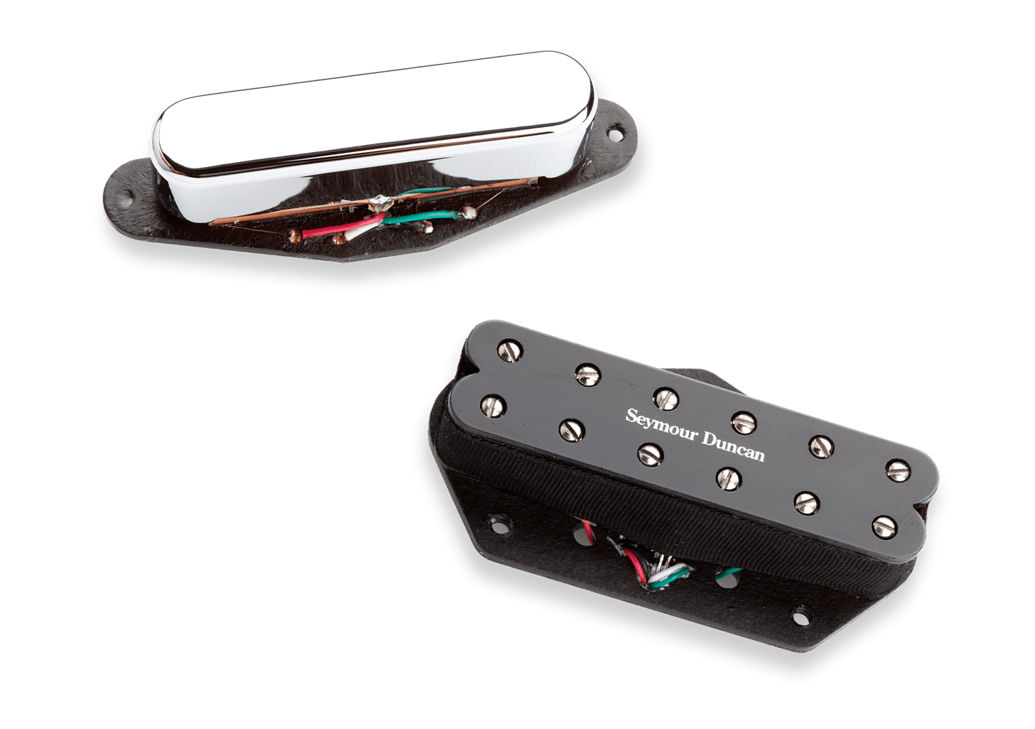

I'm about to make a purchase and need to act fast because I only just found out there is no neck equivalent of the Little 59 pickup for Teles. I don't intend to have a pickguard for this particular build (i.e. I intend to have it mounted to the wood). Any and all advice is welcome.
EDIT: I realize I may not be specific enough -- it's top-routed and it's got vintage tele routes. I haven't found a bridge for it either, but if possible I don't want to use the traditional tele bridge plate, and would rather have something akin to the American Standard Flat Mount, although I also recently learned that that's not compatible with this body.
i dont know the answers to your question but thought i would ask if you bought one of the unpainted sale bodies
No, a Tele neck rout would need to be rerouted to fit a Strat size pickup.

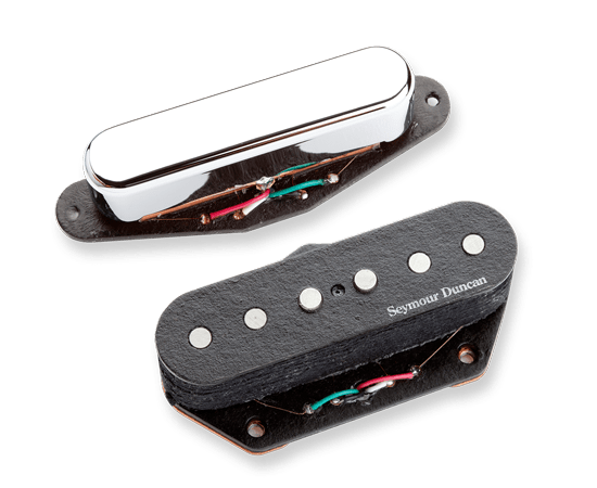

You could use the SD Vintage Stack for Tele neck with it. (Great pickup by the way)
SD also offer this as a set with the Lil 59 for Tele.
Does your body have the Vintage Tele rout with the four mounting holes?
If that is the case this Gotoh fits that Vintage Tele rout - again an excellent bridge for the money.
Yay, thanks for the responses!
I do want the humbucker in the bridge, so I'm thinking about what the best neck pickup to go with it would be if I were to order all in one go from Warmoth. The body does indeed have the vintage tele rout with four mounting holes, but I was hoping for an option that would allow me to drill as few holes as possible. This is part of why I'm looking to direct mount the pickups and not have a pickguard. That bridge plate is pretty much perfect except I want this to not have the plate covering the area.
Some of you may already have guessed why I'm so insistent on having so much of the body visible but I'm trying to keep it under wraps :D
Seymour Duncan make the Hot Rails in a Tele neck size, and if you wire that up parallel you get a sound fairly similar to the Little 59, though with a little less treble and a bit more in the lower-mids. Don't wire it in series or it'll completely overpower the Little 59 (and just about any other bridge pickup). Their Custom Shop can make any side-by-side humbucker you want in a Tele neck size, too, of course at a premium.

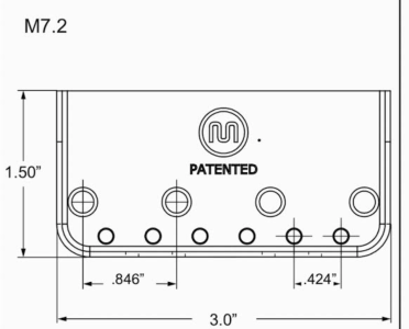

Not to bump my own topic, but just wanted to get some reassurance from some people while I wait for this thing to arrive. I'm kinda looking at this build as a time capsule of 'today', what with the neck having so many modern features (glow-in-the-dark side dots, stainless steel frets, locking tuners etc.), I was thinking of getting a Mastery bridge, specifically the M7. Has anyone installed this bridge on a vintage-style body before? I'm told it should work with a 4-hole setup, but I just really want to make sure.
According to Mastery the M7 is for a 4 hole vintage spec, which the body you ordered from Warmoth is.
Normally I would not comment on the price of parts as at the end of the day it is a personal choice, but perhaps for $180 perhaps you should contact Mastery and get them to verify the question. A half tele bridge can be sourced for about $35 e.g. https://www.philadelphialuthiertool...t-off-telecaster-bridge-with-3-brass-saddles/
I continue the search for the actual half tele bridge I already own...I swear I had it somewhere. I guess I was taken by the hype and reputation of the mastery bridge on offsets. Does the tele incarnation of it make any meaningful difference?
Also, to Mastery's credit, they responded within two minutes of my initial email, but what was sent to me was a screenshot of the M7's dimensions. I'm impressed by the speed of the response, but given I don't have the physical body yet, I can't exactly verify.
Off by a very small amount but if watching copious amounts of Ted Woodford has taught me anything, those things might matter.
Rout:
Mastery bridge:
Could be I'm overthinking it — it's three decimal places, after all.
I am not sure why they have a .846 spacing, as .850 would be the standard vintage measurement. Also, the string through holes have a slightly different dimension.
