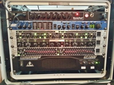

I do. I used single cabs for years.
So much better now, proper crossover and separate amp sections
