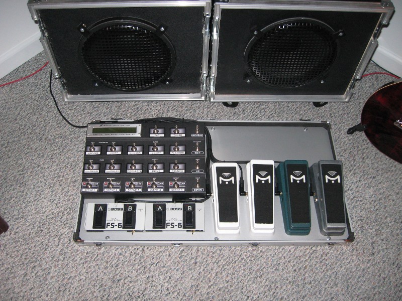

In the case of the Line 6 units, the G50 (floor model) is pretty much everything the G90 (rack model) is for about $200 less and ~100' less range, but it's still spec'd at 200', which is quite a distance. I sincerely doubt I'll ever be on a stage that large. But, you don't plan to work in the extremes. You want a lotta slop. I'd like to be inside about 1/2 the range or less, just so the rx/tx is tightly coupled. At 200', I'd still be in there by a long shot, and I suspect the vast majority of players would. But, in my case, I don't want an audio-handling pedal on my pedal board. As it sits right now, there's no audio signal on the board. It's purely data that along with power all travels along that one little CAT5 cable you see on the upper left corner of the thing...
It's a pretty short line in the picture, but that cable is actually 30' long so you can put that board anywhere on stage.
There's clearly room for a receiver, but then I'd have to run two more lines back to the amp for power and signal. Not gun doit. So, I need a rack-mountable receiver. That way, the receiver's power and signal lines are handled internally to the rack.
