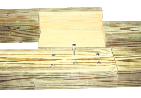

Think of it this way, take two 2x4's and bolt them together at one end. or do something like this;
Which way is going to allow less movement. No, there's no side reinforcement. But the end of the neck butting up against the bottom wall of the pocket is going to hold it firmer. At least that's what I've found. :icon_thumright:
