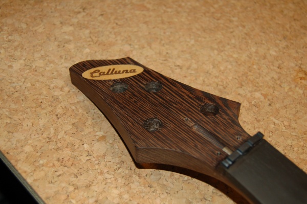

A couple of years ago when I had my small company, I had someone laser cut my company logo from two sheets of veneer, one maple and the other a darker wood, not sure which. From that I mixed two batches of logo's, half with dark and the other half with light background. This one is inlet into a wenge headstock, but I also applied some without inletting and that worked quite well too.
