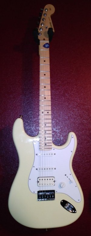

I'm in Colorado. It's super dry here (insanely dry in winter). The yellow Strat in my avatar was built in 2013. I ordered the neck unfinished. I had the fretboard sprayed with satin urethane clear, the face of the headstock a gloss urethane clear, and I finished the back of the neck with about 9 coats of Tru-Oil, and then a coat of gunstock wax. Now almost 13 years later, I have had zero issues with the neck or frets. The fret ends do not even protrude past the edges of the fretboard.thumbnail_20190409_145617.jpg
