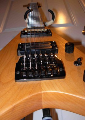

please leave me omments suggestions etc...!!! for my next one in a couple months!!!!
all warmoth
jackson pro style neck with angled headstock reverse headstock, 16 inch flat radius neck stainless steel frets, ebony fretboard on maple neck, corian nut
alder v2 body h x h  contoured heel
volume coil tapping, selector, tone
hardware is
locking tuners
dimarzio x2n bridge
duncan distortion neck
1 meg push pull (coil tap) volume
selector wired normal(double pole center) venter selection makes parralell wiring on both pickups, each other way is normal
500k tone with .022 cap
all shielded wiring and cavaties
and a kahler fixed bridge 3300 fine tuner with stainless steel saddles(3310)

here is detailed images off photobucket
<img src=http://i26.photobucket.com/albums/c143/confederatewk/downneck.jpg>
<img src=http://i26.photobucket.com/albums/c143/confederatewk/upright.jpg>
I just edited your post so we can see the pics ;)
nice axe though!

What's the appeal of the Kahler fixed bridge? And why would someone need or want fine tuners when not using a locking nut?
no binding at the nut, and a higher gear ratio, meaning finner tuning.
