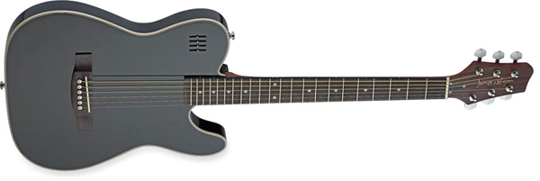

How crazy would it be to use an acoustic bridge with a UST like the Stagg EW3000?
