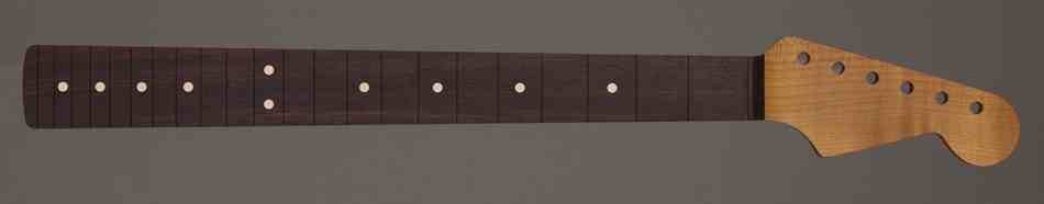

I just ordered this showcase neck and I'm having stainless 6100 frets and a graph tech nut installed. How long do you guys think this will take to ship? No finish as I am just going to polish/burnish the roasted maple.
Also, any feedback on the quality of Warmoth's fretwork? In the past I had the frets done elsewhere...Any feedback is appreciated!

2-4 weeks, I'd suspect, but depends on current capacity.  They usually turn around showcase necks (not getting finishes) quickly.
So far I got 2 and another on the way. One of mine is roasted maple and the new one coming is as well. They burnish up well. As far as the frets I only found one to two that were a bit high and the ends need rounding. Nothing a file from stew mac wont take care of. I knida like the whole process of filling the frets and burnishing the neck. Beautiful neck by the way  :icon_biggrin:

Their fret installation is very good, but they don't do any setup to them. No levelling, dressing or polishing. They set the frets and bevel them, and that's how it ships.
I probably set up a couple dozen Warmoth necks a year, and In my experience there are usually 2 to 5 frets that sit a bit proud. Not much - most guys wouldn't do anything about it as it's usually only a thousandth or two. But, if you want perfect, they need attention. Plus, fret edges that are only beveled and not dressed can feel a bit rough.

Warmoth themselves tell you right on their site that you may want to have someone pay attention to a new neck. They make no claims as to fret happiness.
Plus, if you send it to the right guy, you can get your threaded inserts and tuners installed at no extra charge  :icon_biggrin:
Oh that's reassuring. I'd hate to have to do anything too extensive, but I understand that the fretwork can be improved upon. I'll bond more with the neck having done work on it anyway! Thanks for the feedback! :occasion14:
