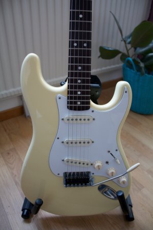

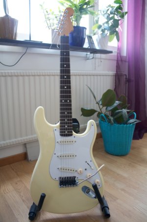

Warmoth Custom vintage strat!
Mattias Svensson
53
Finally done!
Body specs:
1-piece alder body, Warmoth
contoured heel
single battery-pocket
s-s-s top-route etc
The neck specs:
Warmoth modern vintage
10"-16" compound radius
1 11/16
maple/rosewood
21-frets
mother of pearl inlays
stainless steel 6115 frets
Tusq XL nut
vintage tint satin finish
Hardware:
american standard tremolo with callaham block and arm
Graph tech stringsaver saddles
graph tech piezo system
Schaller mini locking tuners
Warmoth White pickguard, 8 screws
Pickups:
kinman woodstock plus with K9-system

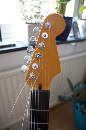

SustainerPlayer said:
Classy looking  :icon_thumright: Now go and cut those string ends.  :sign13:
You ever put one of those through your thumb? It only ever happens once....
Just noticed you're using a Callaham machined block. Do you notice any sort of difference in tone/sustain? According to his website it's the best thing since sliced bread, but I've never talked to anybody who has actually used one.
I used to hate strats and teles, but... after looking at all the nice builds on this board they kinda grew on me. I have a Squier that I'm going to fix up with all new hardware. I know just buying a new strat would be cheaper, but I'm doing it more for the experience.
Anyway, nice classy guitar there, but no strap buttons?
I stood on one of the off-cuts once. Thing was like bloody a hypodermic syringe.
