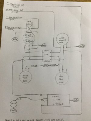

I've been trying to decide whether to use modern or vintage wiring in my forthcoming project.
So rather than decide,  I thought I might install a switch (in the cavity for now) that would allow me to try both options.
I've modified a Les Paul type set up and would appreciate it if any wiring gurus could check over this diagram and let me know if it will work, and any comments.
I'll be using a 3 way switch which should give me: Modern / Tone bypass / Vintage.

As long as you are certain that the switch is on/OFF/on, then it looks to me like it should perform just as planned: Up (relative to the drawing) = modern (volume pot input), middle = tone control defeated, down = vintage/50s (volume pot output). Should be a fun experiment, enjoy! I'm looking forward to seeing that Mooncaster of yours progress!
