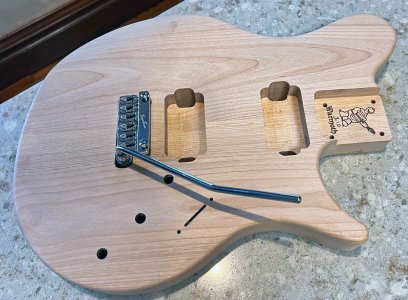

The Showcase Alder Velocity body that I ordered on 3/19 arrived.  I am going to use a Vega-Trem bridge.  I was going to put the bridge on my Fender Jeff Beck Strat, but it's playing so well I didn't want to mess it up so I bought this body to put it on.  Next up deciding on some pickups. I'll probably use Tru-oil on the body.

Just looked on their website, but can't find it....
What is the string spacing used?
Edit....just found it. It's 10.7mm

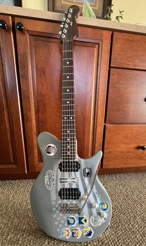

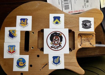

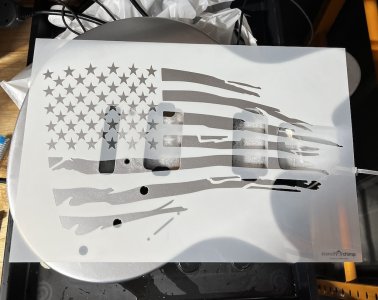

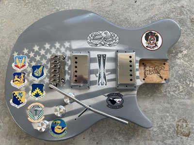

I am hoping to finally finish this guitar up this summer. Life happens... I ended up painting it grey, and am going to paint a flag silhouette, then add the organizational groups I served under. and then finally answer that question about if I like the VegaTrem. I have Dimarzio Transition humbuckers that will be installed, and recently ordered a Warmoth Rosewood scalloped neck to use with this guitar.
Strung up the battle axe using a Warmoth Brazilian Ebony Neck that I put on a Warmoth Chambered Strat I built 4 years ago and setup the Vega-Trem bridge. It was very easy to setup and can do all that they say. Looking forward to stretching the springs more.

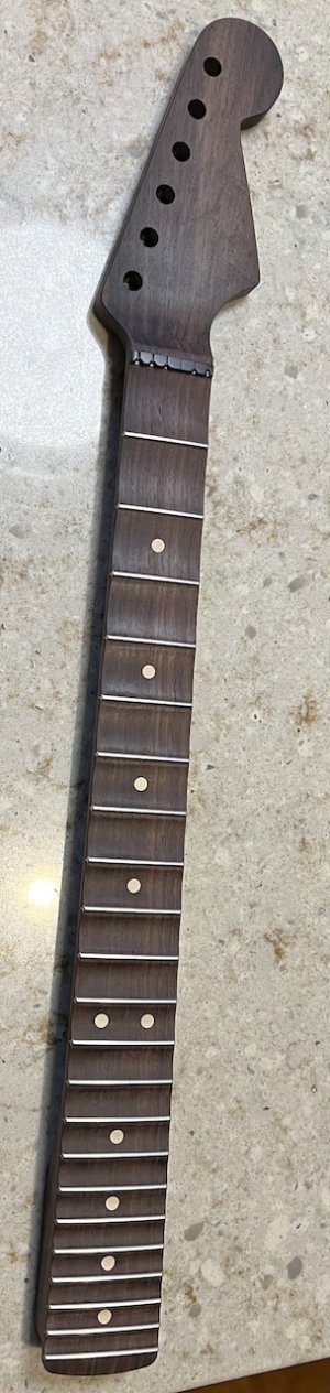

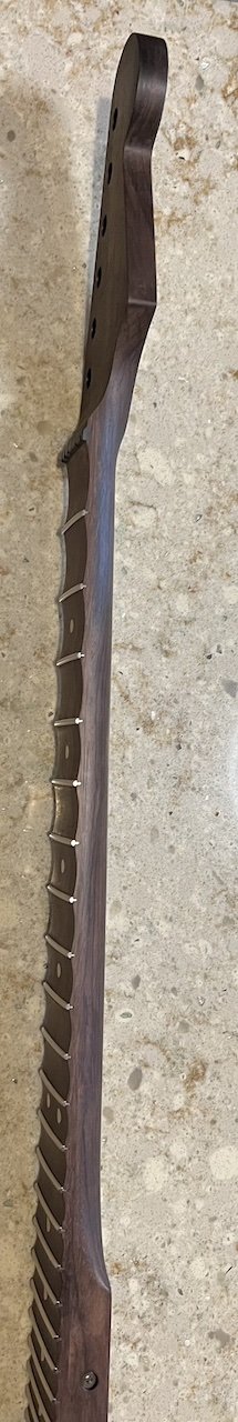

The Warmoth neck that I ordered in early May for this guitar came in last night.
Construction Modern Shaft Wood Indian Rosewood
Fretboard Wood Indian Rosewood Nut Width1-11/16" (43mm) - Modern Medium
Neck Back Profile SRV Fretboard Radius10" - 16" Compound Number of Frets 22 Scallops Full Scallops
Fret Size & Material 6100 - Jumbo (Nickel) String Nut Earvana Nut - GraphTech Black TUSQ XL

View attachment 62375View attachment 62376
Really enjoying this Rosewood scalloped neck and the SRV profile. I've never tried a scalloped neck or the profile before, but figure it would be worth finding out. The only thing I have an issue is with the first 3 frets - trying not fret with the same pressure like I would do with a normal neck, just need to work it. I see why Ritchie Blackmore's neck wasn't as scalloped on those frets.
