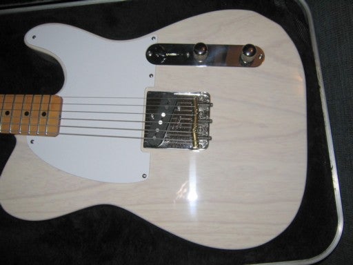

Have you ever seen Mahogany finished the way you're picturing it in your head? If I'm understanding the effect you're shooting for, I don't think I have, outside of what's often called a "Mary Kaye" finish...
...which is a translucent finish as opposed to transparent.

Then, I like that color a lot! I may have to try the Surfer Girl if that is the result. I found that the Dairy Blonde didn't cover the way I liked, either, so I added about 20 drops of white India Ink to it to get the opacity I wanted.
