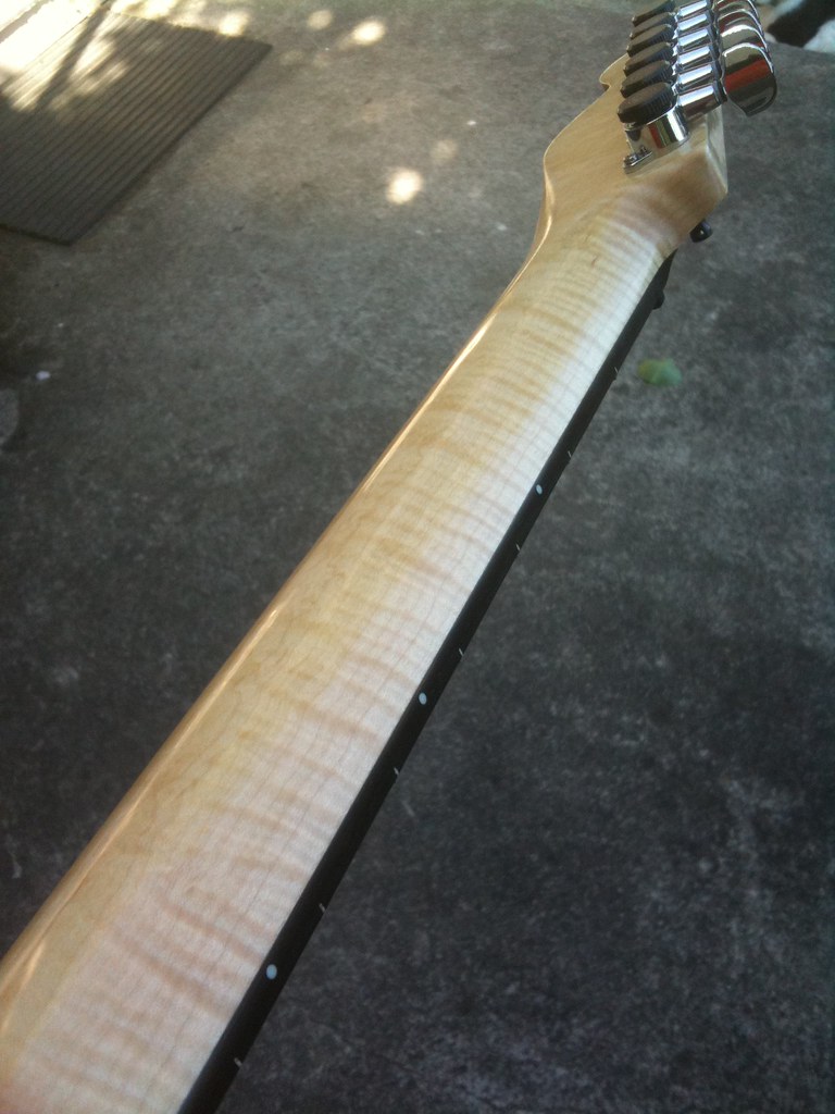

Yep!  This is about 5 coats of Tru-Oil.

Well, note that my photo is of a Tru-Oil applicatoin, and yours is tung-oil.  The two products behave differently. Also, maple is a tight-grained would, so buildup will go faster than on your deep-pored korina body - and possibly the bloodwood or bubinga you're working with on the neck.  The oil doesn't soak in so much on maple.
