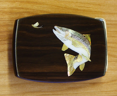

Also thinking about a headstock inlay similar to this:
