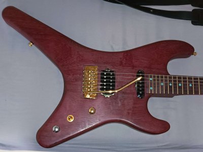

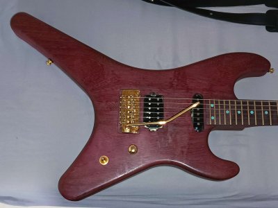

Hello guys,
Almost one year after I build my purpleheart guitar I came to the conclusion, that I would like to add a tone knob to it.
I planned the guitar without one, because I rarely use them on other guitars. One of those rare occasions is, when I wanna use an octavia (octave up fuzz), which sounds best with the neck pickup and a closed tone pot.
It would've been strange to build a purple guitar and not being able to play Purple Haze with an octavia, because the tone pot is missing.
So if you pull the volume knob, it "activates" a 22nF tone cap on the neck pickup, that was my solution at the time.
What I didn't think about then: A strat singlecoil in the neck position without a tone pot sounds much brighter than what I am used to. So now I wanna add one.
Luckily, the rear cavity is big enough for another pot, but I'm not sure if I like the position. What do you think?
This is without it:
And here I put a chrome knob where the tone pot would be:
That is about as far as the rear cavity goes into the "corner", maybe 1 or 2 millimeters further away from the toggle.
I want a tone knob, but I also like the controls now.
I am open for suggestions!
