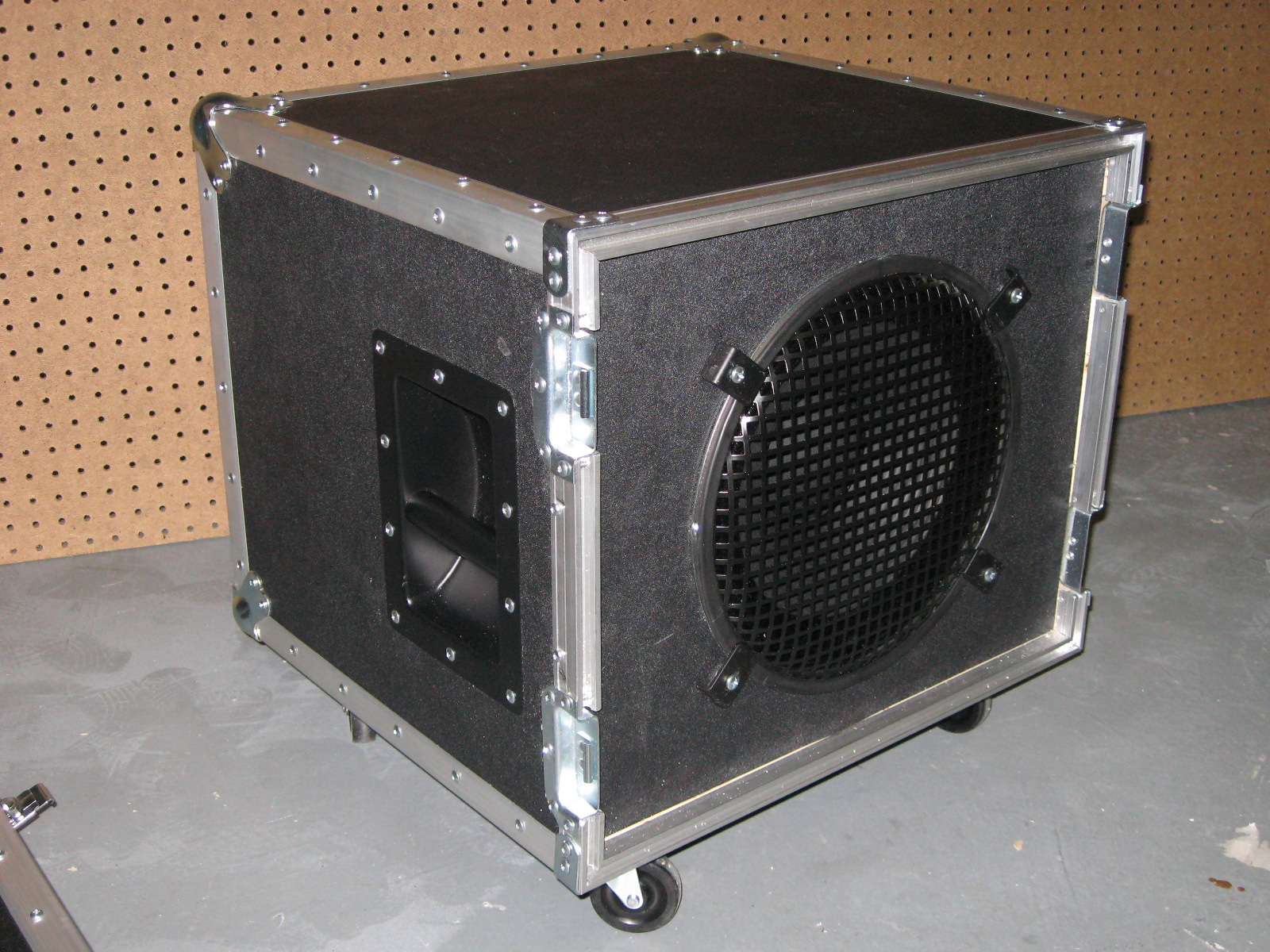

I recently built a cabinet where I went deep, and it had a profound effect on the tone and frequency response of the thing. It's just a 1x12, but it's a beastie little thing...
I did the dual-dado joints with cleats, all glued and screwed, rather than finger joints, inset the front and back panels (also glued and screwed), used 9 ply 3/4" void-free birch, covered it with ABS, and obviously reinforced the edges and corners with extruded aluminum and steel. I put the latches for the cover on the cover, so they wouldn't vibrate on the enclosure when it was open and set up to play. There are feet underneath so it's stackable (it's sister cabinet is currently in-process) once the plug-in casters are removed. The speaker is currently WGS's version of a Celestion Vintage 30, which they call a "Veteran 30" you can read up on at http://warehousespeakers.com/proddetail.php?prod=veteran30_12. This thing romps! It has all the tone and definition you'd expect from a V30, with the chunky low end you'd expect from a 4x12.

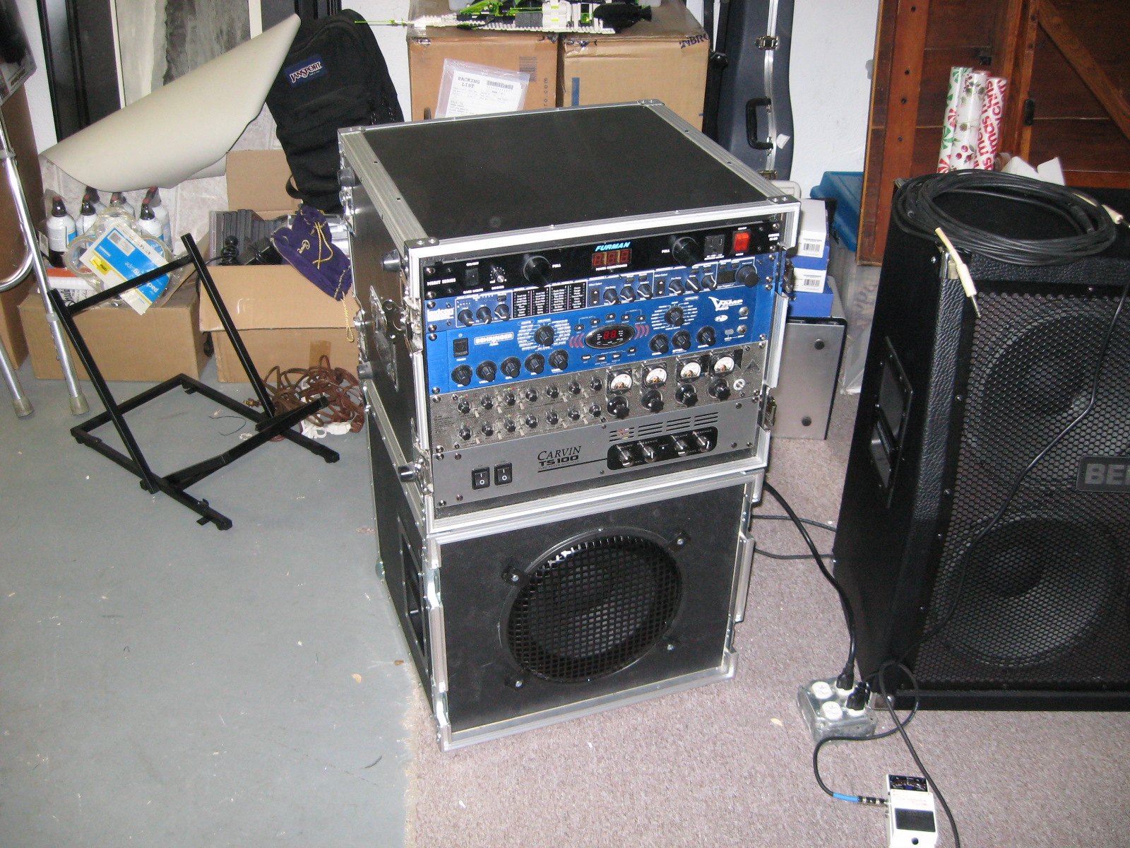

Fits nicely beneath the dreaded rack, too...
The rack and speaker boxes are actually the same size - that picture is shot from a high angle. The handles on the speaker cab are set forward to compensate for the weight of the speaker and the front cover when it's on, so it balances right.
