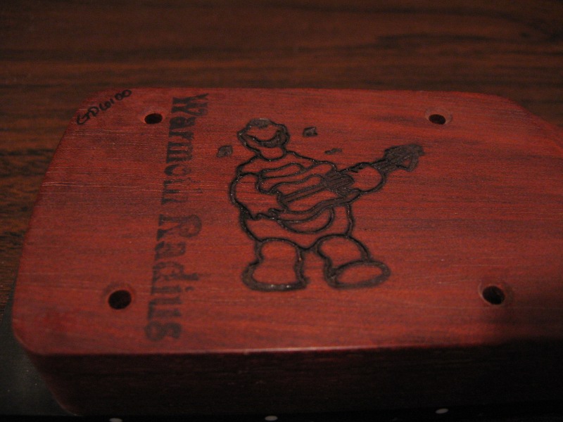

Warmoth's logo burning/imprint tool either suffers wear or operator-based inconsistent usage or both. I've got bodies/necks here from them that were barely embossed, and others, like the last few, that looked like something had changed because the logos and text were quite clearly stamped with something hot. For instance, this is a newer part (this month)...
You can see how well-defined the the Turtle is there. I mean, it's embossed deep enough that you could probably fill it in with paint or something and make it look sorta like an inlay. The "Warmoth Radius" mark is obviously just a rubber stamp.
Another change I've noticed is they're embossing the part of the heel facing the bridge with a number/letter combination. Not sure what that is, and I didn't take a picture of it. But, mine says "989 SS" or "SS 686", depending which side you call "up". I don't recall ever seeing that before.
