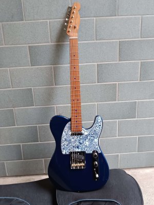

Hallo Leute!
A lot was already discussed in the build thread
👉here👈

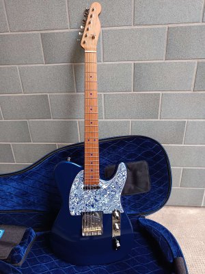

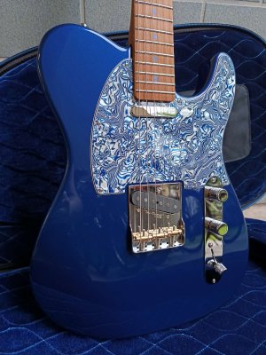

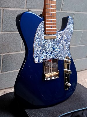

But here she is now, meine blaue Teilecaster!
And yes, I realised, too, that taking pictures of a blue guitar in a blue case isn't the smartest move 😅
I will go over the specs again real quick:
Body was from the showcase with added paint:
Tele® Replacement Body
Construction:
Solid
Core Wood: Swamp Ash
Body Upgrades: Multi-Piece for Solid Colors
Right / Left Handed: Right-Handed
Control Cavity: Top Rout
Neck Pickup Rout: Universal
Middle Pickup Rout: None
Bridge Pickup Rout: Tele®
Jack Rout: 7/8" (22mm) Side Jack Hole
Bridge Rout Type: Hardtail
Bridge Rout: Vintage Telecaster®
Mounting Holes: Standard 4-Bolt
Neck Pocket Shape: Tele®
Paint Category: Metallic
Top Color: Spectra Blue
Back Color: Spectra Blue
Satin or Gloss: Gloss
I added a custom neck to the order:
Telecaster® Replacement Guitar Neck
Construction:
Modern
Shaft Wood: Roasted Maple
Fretboard Wood: Roasted Maple
Nut Width: 1.650" (42mm) - Vintage Medium
Neck Back Profile: Fatback
Fretboard Radius: 10" - 16" Compound
Number of Frets: 22
Binding: None
Fret Size & Material: SS6105 - Narrow & Tall (Stainless)
Tuner Hole Size: Vintage Style (11/32")
Inlay Shape: Premium Dots
Inlay Material: Azurite Malachite
Side Dots: Luminlay w/ Black
String Nut: Standard Nut - White Corian
Neck Heel Shape: Tele® Shape
Finish: None

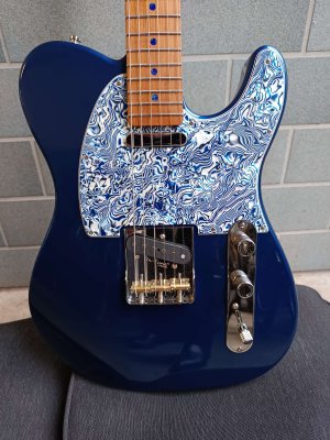

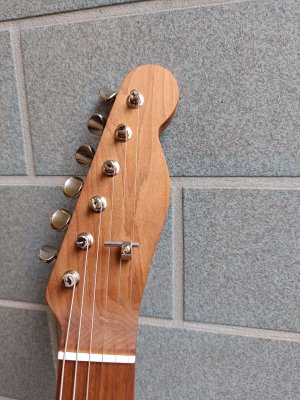

That string tree is a Göldo String Three. It puts the plain strings in about the same angle as the d-string. And it looks cool.
I also ordered a blue shell pickguard, neck plate and pad, neck screws, low profile pickguard screws, Gotoh vintage tuners und the Gotoh vintage "In Tune" bridge from Warmoth.
The pickups are a Rockinger Telly Rhythm and a Rockinger Telly Twister bridge. All the other parts I also ordered at Rockinger in Germany.
The wiring is basically standard 3-way wiring with 250k log pots, but with 22nF tone cap and treble bleed.
The guitar sounds awesome and looks even awesomer, I think all the different blue parts came together really nicely, spectra blue, blue shell pickguard and azurite malachite dots just look like they belong to each other!
I didn't plan accordingly, but it even looks as if the Reunion Blues Case was made for that guitar 😅 Oh, I think I will need a blue strap for that...
Total weight is 3.45 kg or 7.61 lbs
I wanna thank everyone who commented and reacted in the build thread. I don't wanna dig any deeper in this than saying: I'm having a bit of a hard time right now and I can't change that, but being here in this forum, among other things, really helps. Dankeschön! 🥲

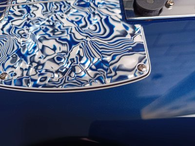

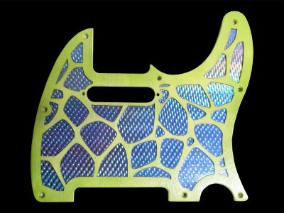

Came out great! (maybe a cool aluminum guard would really pop it, the shell gives me a headache, but I am odd.)
Actually, I noticed a quality in the blue shell I didn't think of before: You can't see my sweaty fingerprints immediately! That is a very good quality. The black one didn't have that!
I am actually serious it would look great!
I'm sorry spud, I meant no disrespect. 🙂
This is again not what I had in mind with this guitar and I found that kind of obvious and asumed a joke.
Orange pearl over a dark blue is kind of the most contrast possible and there is a part in me who likes that, but it's not the part that builds a (rather) classic telly 😅
More an Iceman, or a V (I loved the old Flying V shape Warmoth used to offer) with high output humbuckers. 🤘
Thanks for your input though! 😊

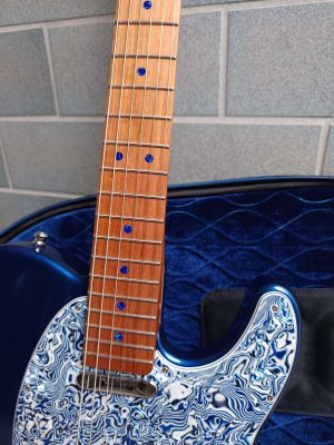

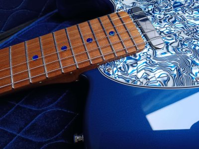

Ah verdammt, I totally forgot to write something interesting about the neck:
This is my second roasted maple neck from Warmoth, but I didn't notice it the first time, maybe because I was still smoking by then, or because it was a different batch of wood, I don't know.
But the smell! Aaron once talked about the pleasent smell of roasted maple in a video and with this neck, I smell it every time I pick it up!
It's hard to describe but I find it very nice!

I have two Warmoth roasted maple necks; first one had a strong smell, almost maple syrup-ish, for a couple of years! The more recent one did not have a smell

My last roasted flame maple neck on my Rosewood Soloist build had a pretty strong aroma, especially after burnishing. Love it !
