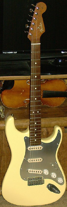

Below is another build from days gone by. This one was acquired off eBay and underwent a makeover. It has a Warmoth modern side adjust neck with Gibson size wire, Clapton profile, USA Fender vintage spaced trem, Fralin Blues pickups, etc. When received the overhang was somewhat pressurized against the thick pickguard however the previous owner did a nice job stripping the Fender SSS 4 bolt body and installing the decal, tuners and string tree The Gibson size wire on this neck actually to my surprise felt pretty good.
Before makeover...
After makeover.
Cover holes were filled, bore for the trem arm was filled and 5 springs installed, one way or another it was going to be a hardtail.
Neck was attached using inserts, shallow rout is for the heel mounted ProAttach II Rail to occupy. Fender cut this pocket floor on the narrow side, still had ample room left for the rout.
New owner initials at the pocket. It was a fun project that went to a good home.
