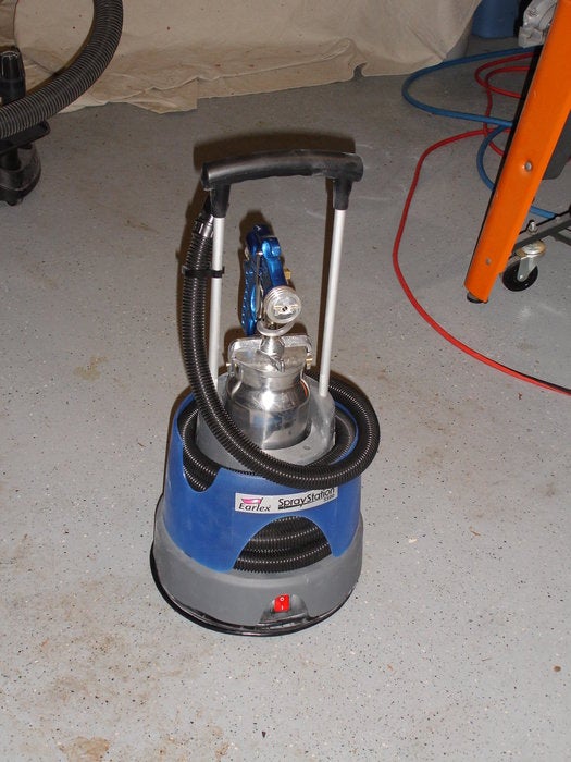

If you do decide to gear up to paint, you may want to consider one of the Earlex HVLP units. I use this one, and get great results. If you're not familiar with HVLP spray rigs, it's a somewhat different way to shoot coatings. Instead of using a high air pressure to atomize and move the paint, it uses a high volume of air. So, there's no compressor, per se. It's basically a turbine. It only develops about 4psi, but it'll move 42cfm of air. Oddly enough, for blasting so much air, you end up with a lot less overspray and waste.
Anyway, it's small, light, inexpensive ($300) and returns professional results. That's roughly the cost of a single paint job, so you get you money back quick. You're ahead of the game halfway through your second body.
If there's any criticism of the thing that I could offer, it's that you're stuck with the gun it comes with. There doesn't appear to be a gravity feed aftermarket unit available. Not that it's a bad gun; far from it. But, if you want to shoot sunbursts, that vacuum feed paint cup can get in the way while a gravity feed cup won't.
