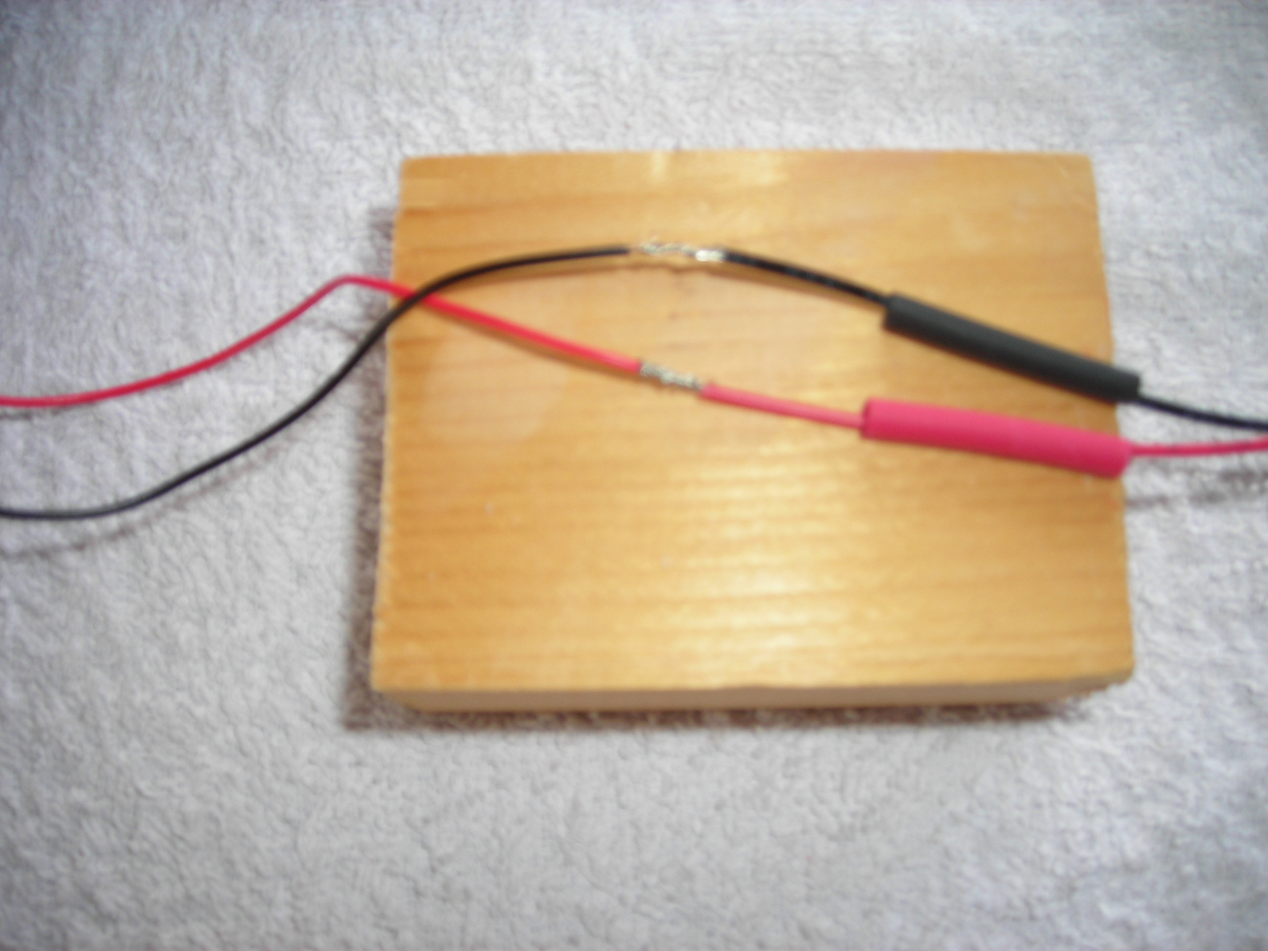

If you do have to extend the wires for some reason if you are not using traditional LP wiring.
Twist the wires together, solder them and use some shrink tubing to insulate.
Here is an example, in this case for EMG battery leads but the principle is exactly the same.  After soldering the wires, let them cool, slide the shrink tubing over the join and use heat to shrink.
Yep.  I also like to first tin the wires, then use needle nose pliers to make hooks out of them.  Hook the wires together, pinch the hooks together, solder, then heatshrink.  The idea is to create a good mechanical connection as well as the solder.
Ahh that makes sense why they would rout it that way. We had it routed for only a master volume and tone, so I'll extend the ground cable with some wire. Could I use electrical tape to insulate? Or would that not be as effective?

Yes you could use insulating tape, though I would prefer shrink tube if you can get it. The important thing is getting that mechanical and soldered connection.
