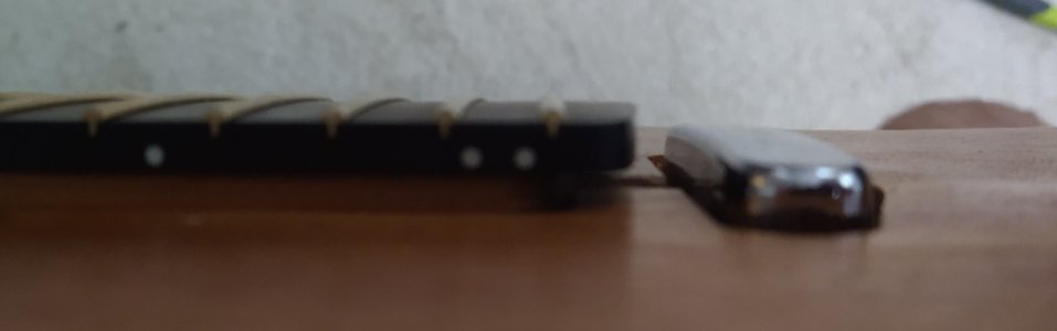

This is fully seated
Well, take the neck off, put the pickguard on, put the neck on, rock on.

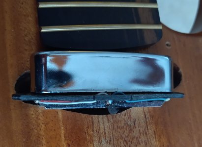

Need a pic with the pick guard and tele neck pick up installed to see how bad it is.
Not sure how much assembled would help. The thing is that the overhang on this baristrat neck is about half of the very short length of pickguard between the neck pocket and the pickup route and its not even close to enough length to flex enough to slide over the pickup which is bottomed out here. The pickguard would break. if I tried. The pickup is mounted to the pickguard so i can adjust without removing the neck

Sounds like there is something funky going on with your pickup, and you probably need to take out your dremel and make the hole bigger. Do you someone in your neighborhood you can trust to take a look at it? Bandmates, busk buddies, luthier?
Also, can you take pic that shows the full body?
