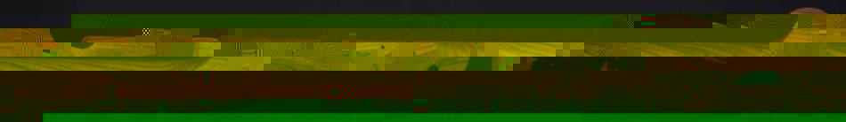

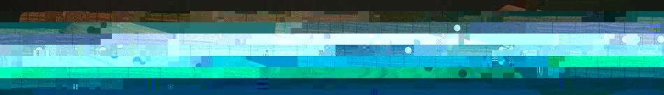

Ok, so I've got my first Warmoth neck on the way  :blob7:  :blob7:  :blob7:
But I need a body for it, and I don't have a ton to spend, as I'd like to have cash left over to have it set up professionally. I need some opinions on a  couple different points. First off, let me explain what music I play, and what sounds/feels I like and do not like. I primarily play slow/medium blues and basic four chord rock n' roll crunchy stuffs. The blues is what I want to focus the guitar on, but if I can get some crunch out of it too, I'd be very happy. So here's the deal. I've been playing a friends guitar for a while now, but it is very dry. I have to really hit the strings pretty decent to get any longer sustain, and the harder I hit, the less juicy it sounds . . . it gets a lot of bite going, which for slow blues is a big much. The body and neck of the guitar are also pretty dead feeling (think big fat Les Paul). understand me? it feels like a paul, like the body and neck are just a big dead mass in which the pickups are mounted in order to capture what the strings are doing . . . but the body just feels like the structural support and not really like its part of the musical equation. What I'm after is a guitar that sings real easy. I don't want to have to hit it too hard to get it there, either. So here are my two questions:
1. Is it good or bad for a guitar body to vibrate when played (considering my desire for a singing guitar)? does this help or hurt sustain, etc?
2. Single coil Pickups: Hot or not? Will hot pickups or normal pickups be better for what I'm wanting? I want to make sure that the neck and middle pickups really sing. What about the bridge pickup? most starts I play have a lot of bite in the bridge, which is fine (as long as the other pickups can give me the juice). Would it be better to take the "bite" sound and run with it in the bridge, and what pickup type will be good for this?
Here's the neck I got:
Warmoth Pro
Pau Ferro/pau Ferro
SRV contour
SS6230 (vintage) frets (stainless)
MOP dots
22 fret,compound radius
GraphTech white nut
vintage style Gotoh tuner holes and chrome tuners to match

First.beautiful neck, I know why you ordered it

That's a really fantastic looking neck. When I saw it show up on RSS the other day, I was thinking, "I wish I had a good use for it". I'm glad someone here got it (and good move pulling the trigger quickly).
