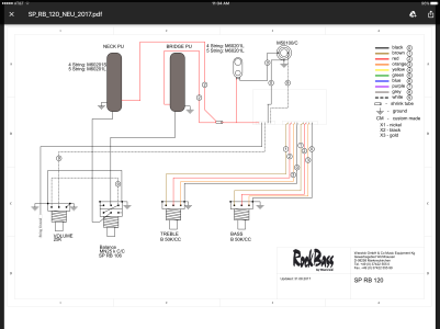

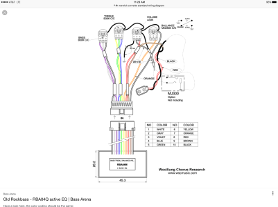

I have a bass build I recently completed.  I used active pickups, pre-amp and hardware from a Warwick bass.  I put it all together and it was working fine.  After about 2 weeks it stopped working.  Just a tiny bit of volume is coming out of the bass.
First I changed the battery.  No difference.  I pulled the cover to expecting to find a dropped wire.  No issue there either.
The sound of the bass seems to be sensitive to the volume knob.  All the way up, no sound.  All the way down, no sound.  However there was a bit of volume when the knob was someplace in the middle.  I replaced this knob but the new ones produces the same result
I confess I am horrible understanding electronics and switching, especially with active stuff and pre-amps.  Any ideas here on where to start??  There is a CAP on the volume knob...could that be it?
I am pretty sure this is it.
