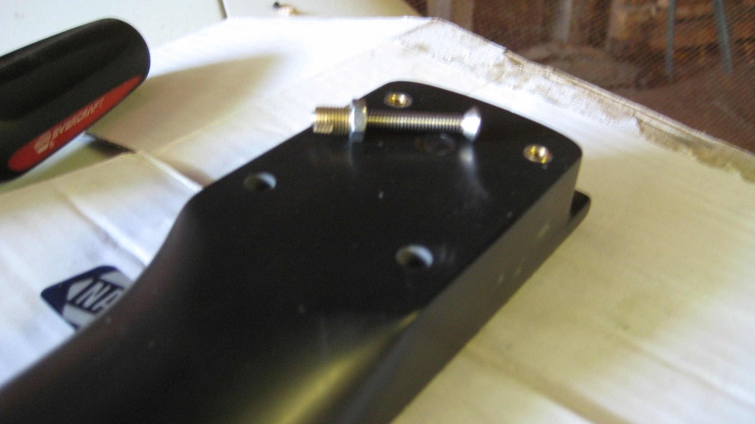

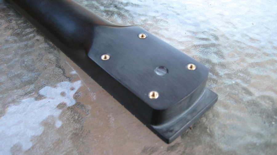

The neck inserts are pretty easy and a lifetime fix. The first time I installed them I used a drill press. The photos here were of a graphite neck I put on a Warmoth body. The second time I used inserts was on a Warmoth Pro 12 string neck. I didn't feel like walking to my shop and I just grabbed the household battery powered hand drill, taped the bit where I wanted to stop and very carefully kept it lined up. That worked fine and with wood, it seems safe enough.
Driving this type of insert in was a matter of locking a nut against the insert and using a phillips. On the Warmoth Pro neck, it took no more than a few minutes from start to finish. The inserts cost me $5.00 per set and the drill bit (which I've used for a few sets now) was about $8.00. Study the issue of strength and chemical interactions of metals if you have concern, there are many threads around with in-depth plausible information.
Forgive the size of the first photo, I wanted the screw locked to the insert to show up.
