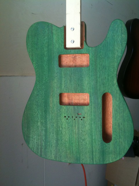

I should think it will be easier to get that kind of effect with basswood than with poplar, given poplar's tendency to have a lot of green streaks.  Usually you see basswood and poplar with solid colors because they are so visually uninteresting compared to other species. Obviously you'll want to pick up some lumber to experiment on.  Poplar and basswood are both pretty cheap, and available at your local big box home improvement store in small project precut sizes.
But I got that kind of result on my green tele (after a great deal of experimentation) by making a stain out of Mixol universal pigment in a vehicle of 2:1 lacquer thinner and lacquer retarder.  That was on mahogany, though, and I'm not sure how well basswood or poplar will take a stain.  This example was done using  Mixol No. 13 Grass Green.
