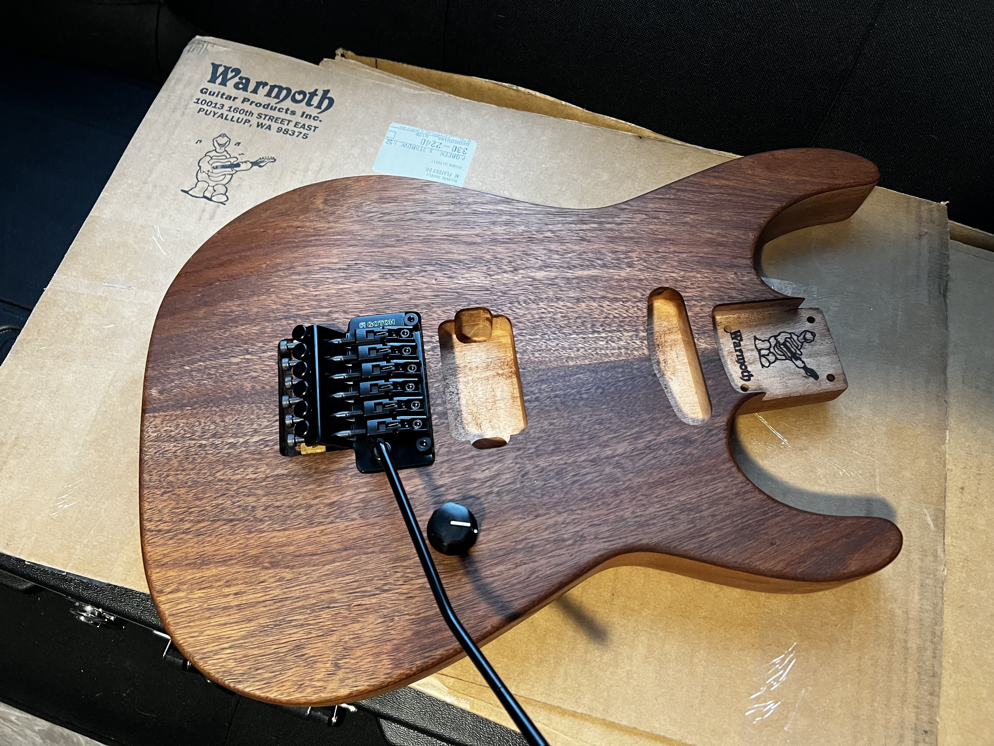

So i got my neck and body in the other day, unfortunately i had to send the neck back to as they didn't do the Floyd shelf it is what it is, its on the way back and they are going to take care of it and send it back.

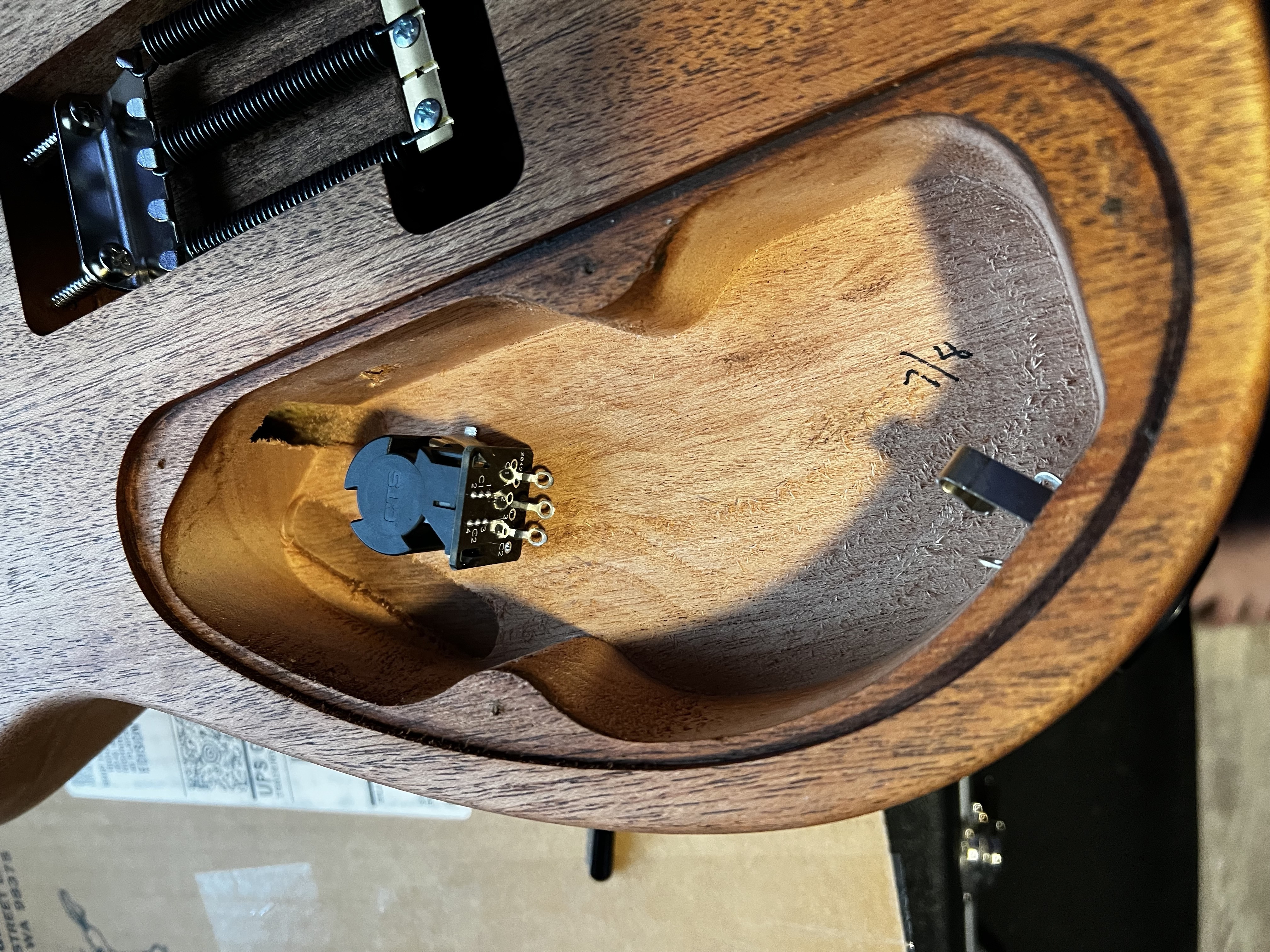

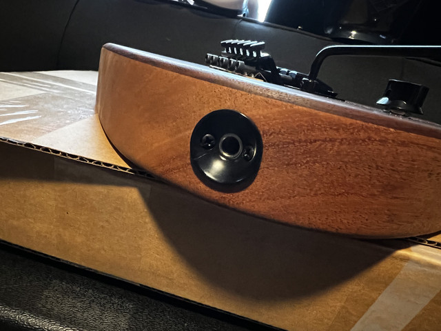

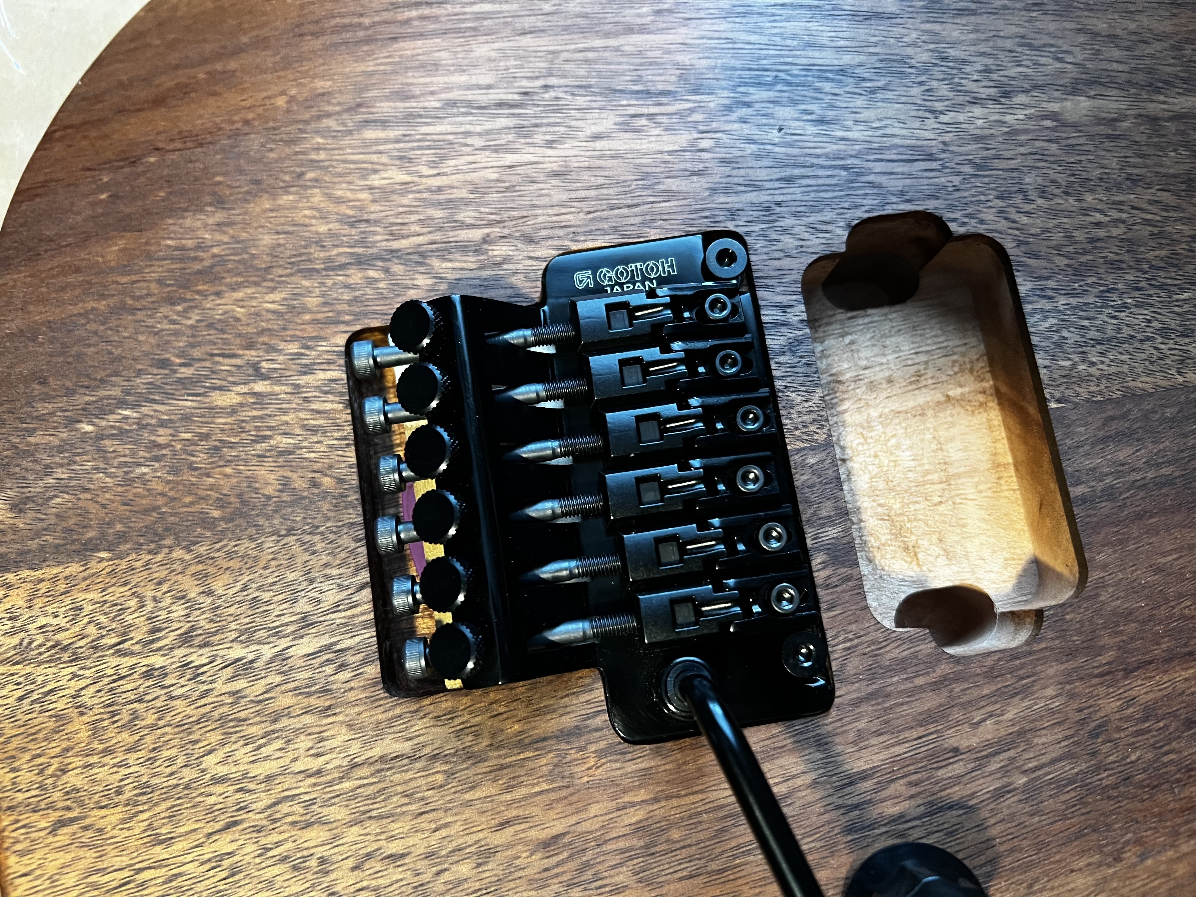

In the meantime i did a little work on mounting the Gotoh 1996, drilling for the Vol pot (Lynch Wiring the push pull is the pickup selector) and mounting the input jack. The finish is Montys Guitars Montypresso wax, nothing fancy keep it as raw as possible.

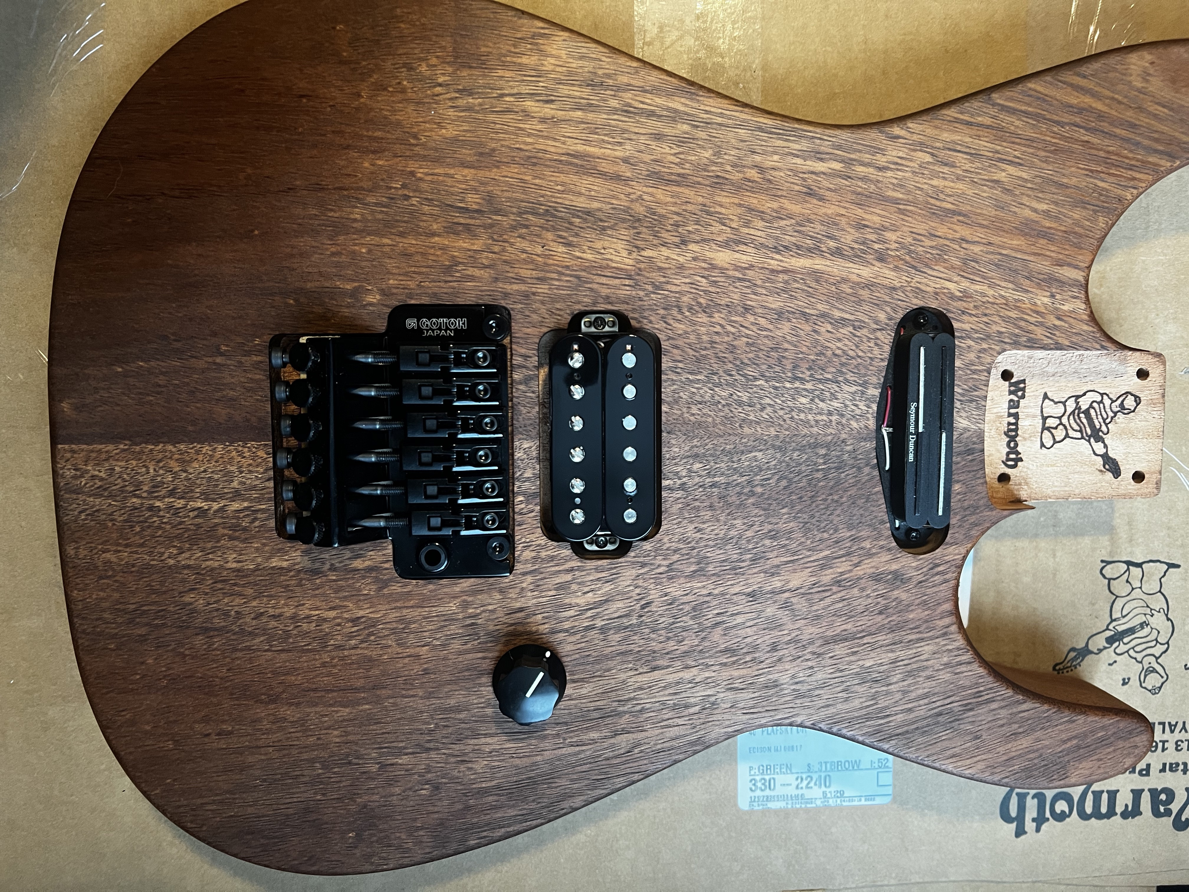

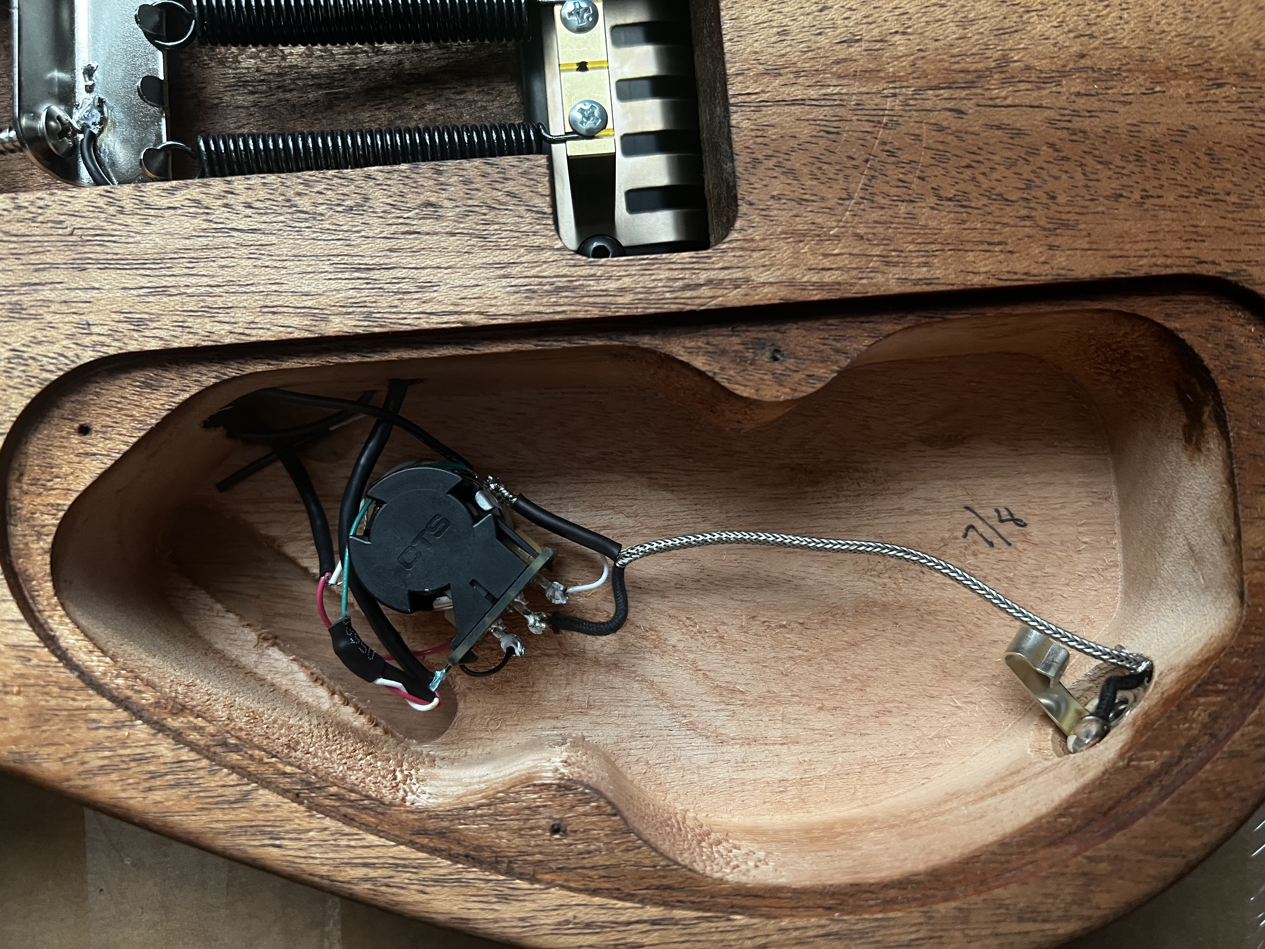

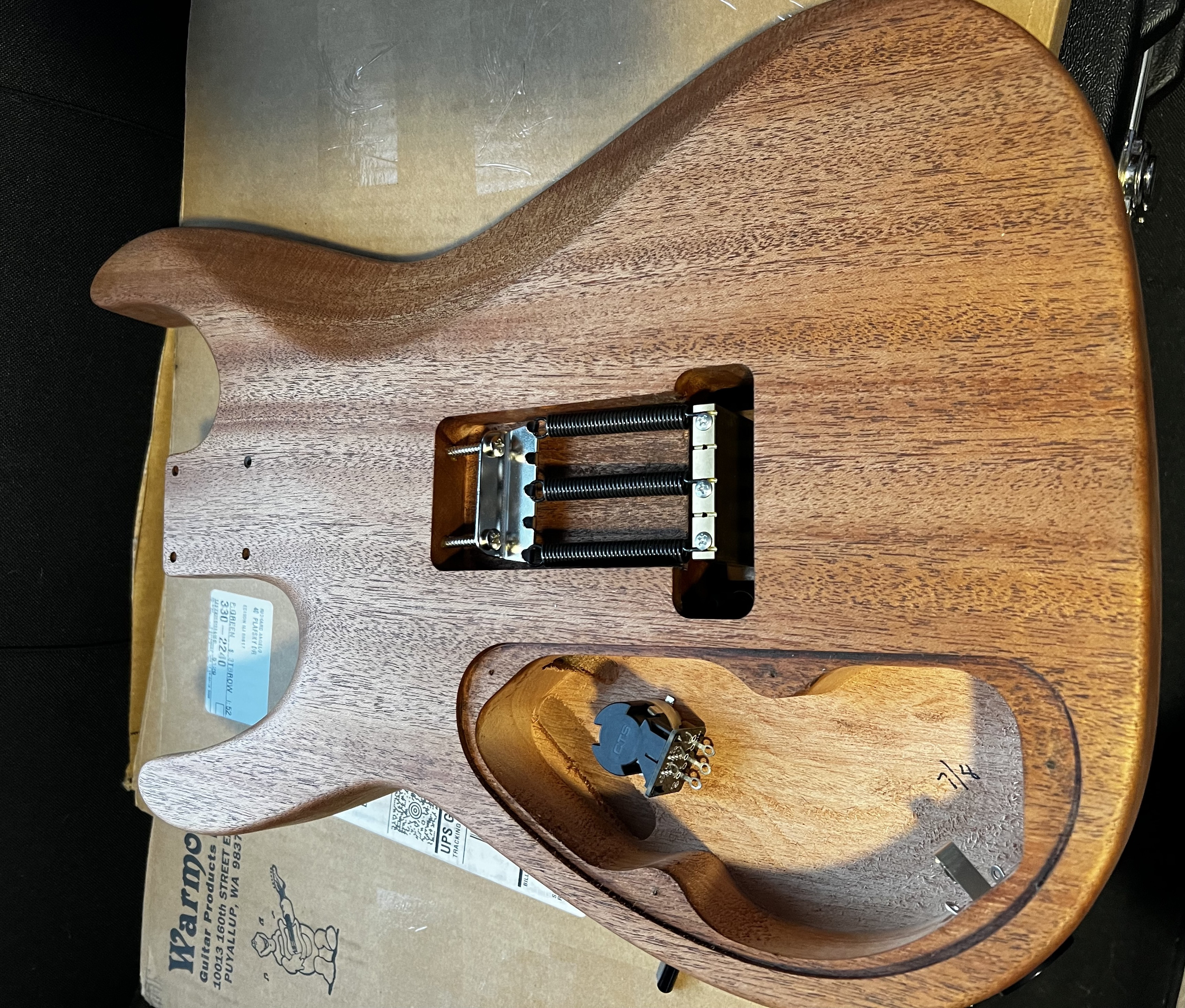

So i decided to mount and solder up everything today. Duncan Custom in the bridge and Vintage Rail in the neck
NedRyerson said:
That's sweet.  What are you using for the mounting screws?
Thanks
Mounted the bridge with the FU-tone PMS https://www.fu-tone.com/product/pms-pickup-mounting-system/
Neck is just a strip of foam for height and some tele mounting screws.
I love the simplicity of the layout and the overall minimalism of the aesthetic!
How's the noise with that simple of a layout and no shielding around the cavity?
Hope you get your neck back correctly soon!
Thanks
I have no noise, my other soloist body is wired the same way. with no shielding and I get no noise. I don't think shielding is needed with humbuckers, but that's my opinion.

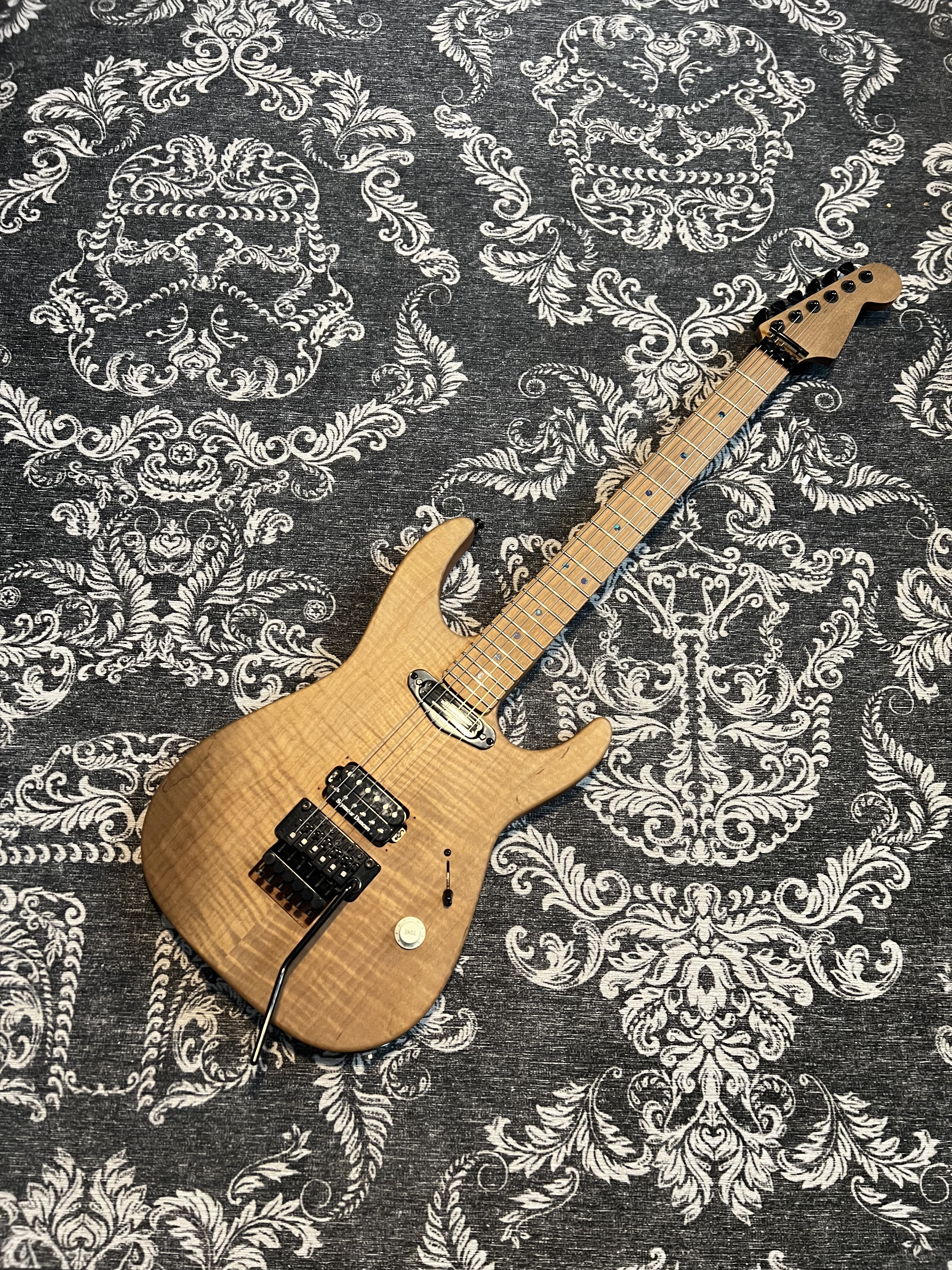

Heres a pic of my 1st build from about 7 years ago.

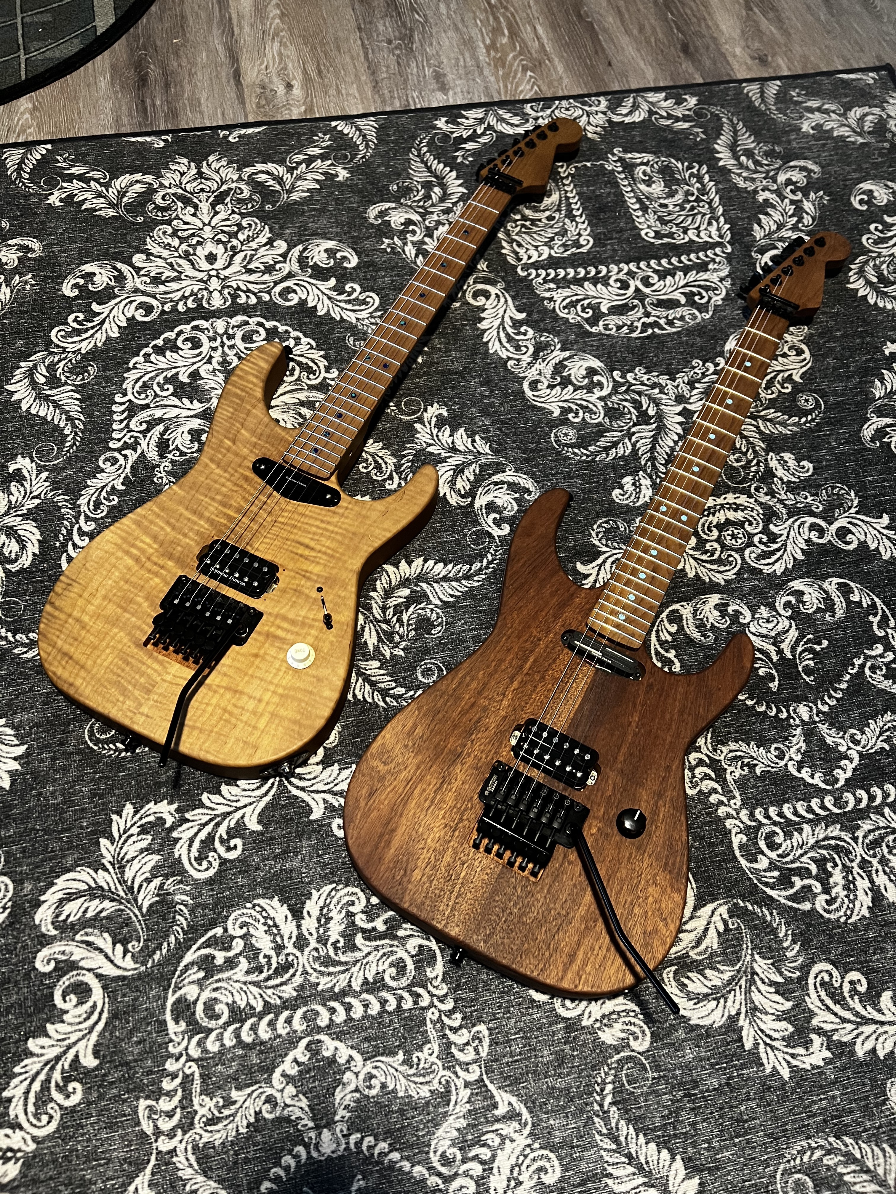

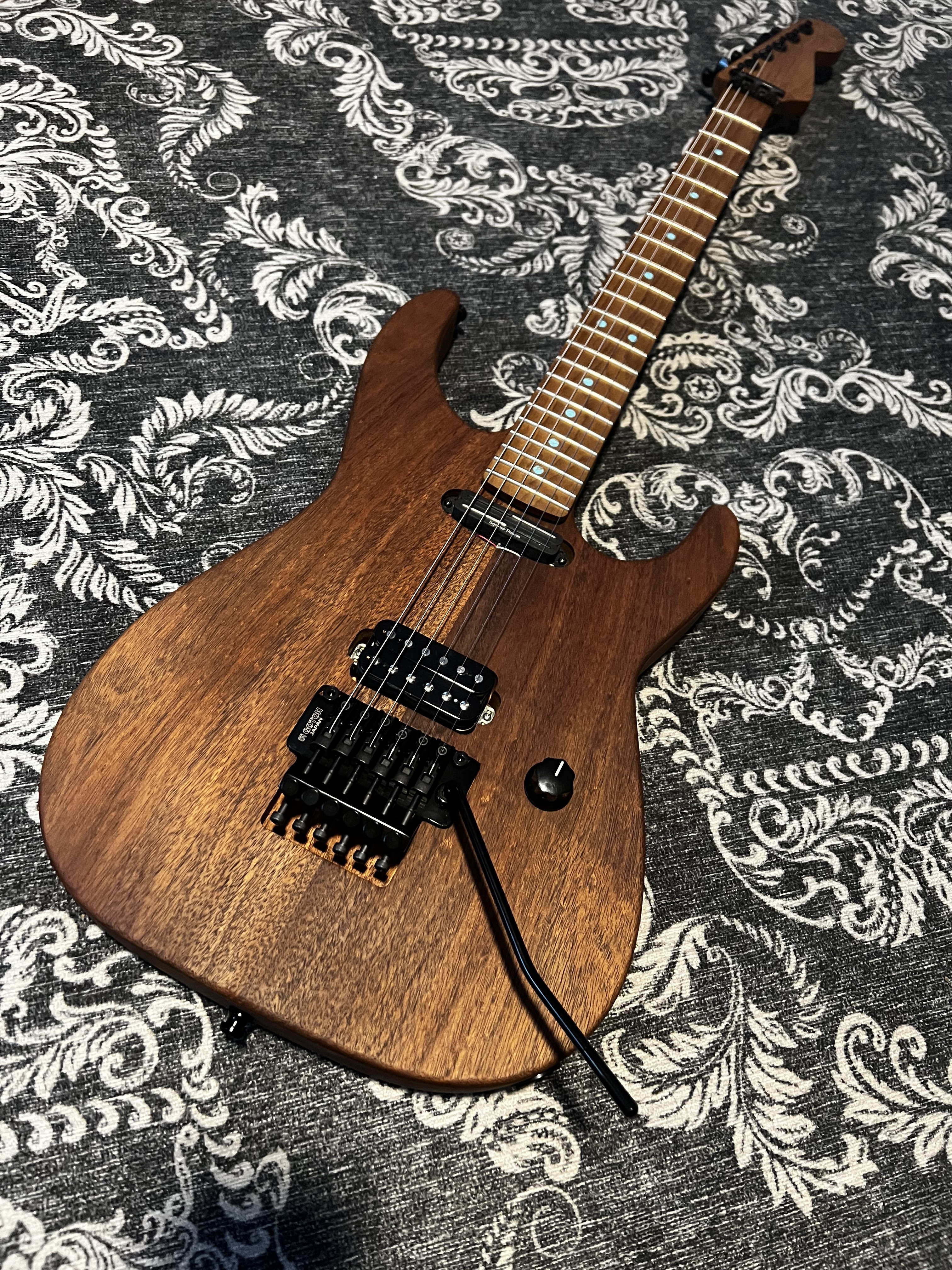

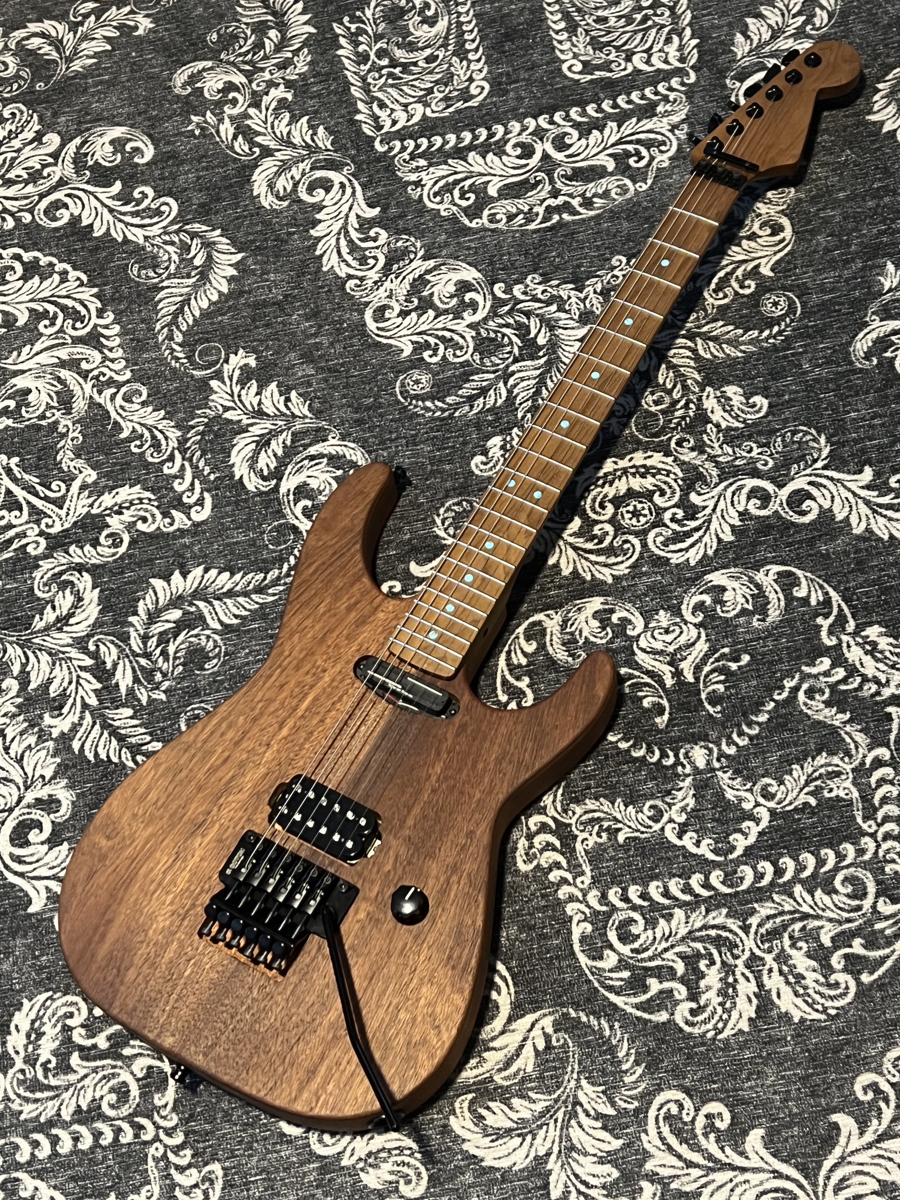

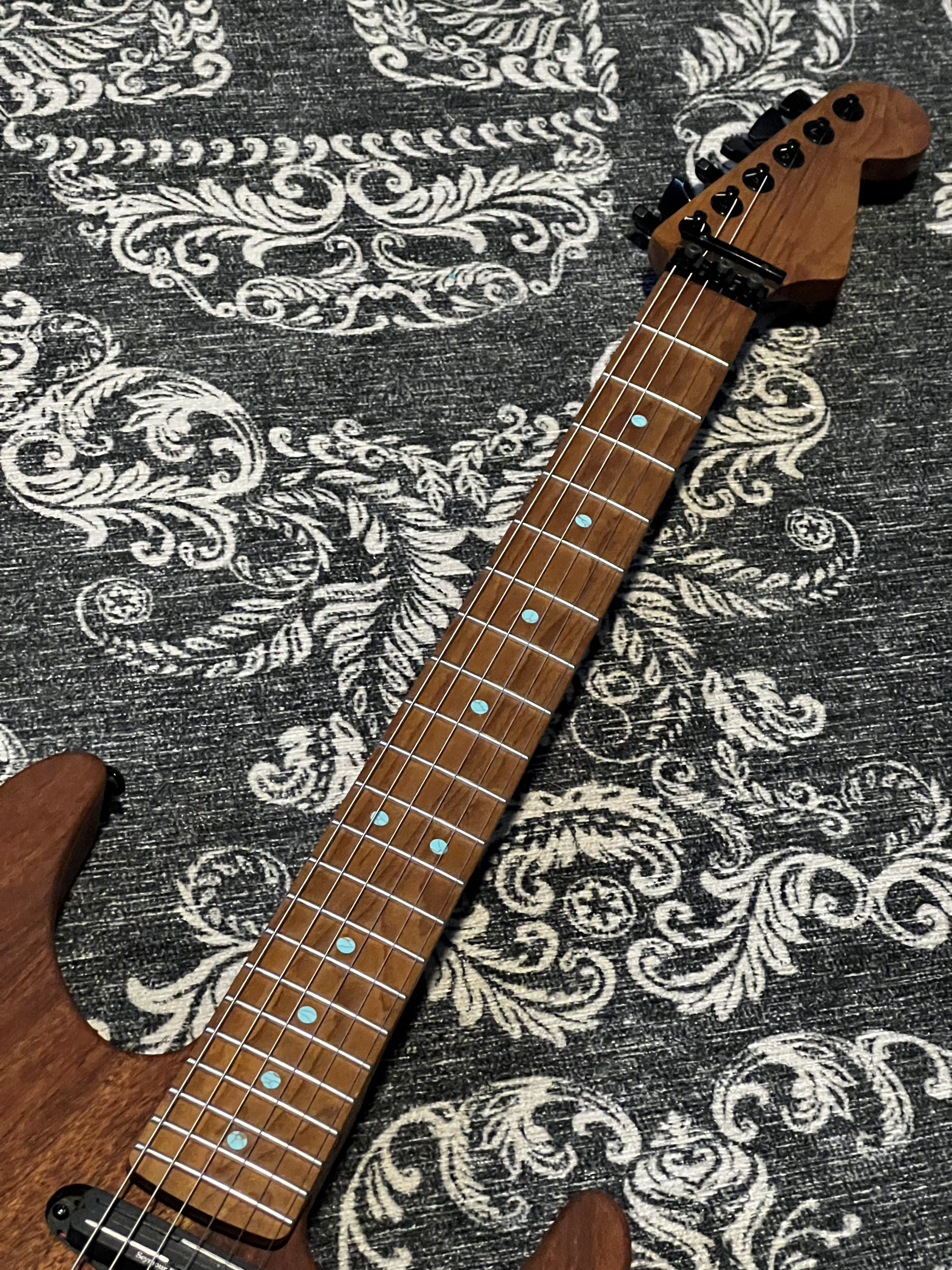

So i got my neck back the other day and with the nasty weather here in NJ this weekend i decided to bolt it up and get it playing. It set up great action is at about 3/64ths at the 22nd fret which is right where i like it. I also included a shot with his 7ish year old brother and my 1st build. there is a def theme that runs with them as i was going for that Charvel San Dimas Style.
Specs for the body were Mahogany and Koa its got a Duncan Custom in the Bridge and a Vintage Rail in the neck, Gotoh 1996t trem and a CTS Push pull for the pickup selection.
Neck is fully roasted Maple, 1 11/16 nut width, R3 Floyd nut, hipshot griplock tuners, Wolfgang neck carve, 10-16 Radius and Turquoise inlays.
I'm usually not into the all natural woods look, but there is no denying these two look really great.
