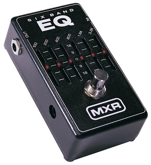

The other thing you can do is channel switch your amp, or kick on some sort of booster stomp box. MXR makes a little 6 band graphic EQ that functions quite nicely as a booster and gives you some nice tone control at the same time.
Damn thing eats batteries like they're free, though, so if you go that route be sure to get a power supply for it.
