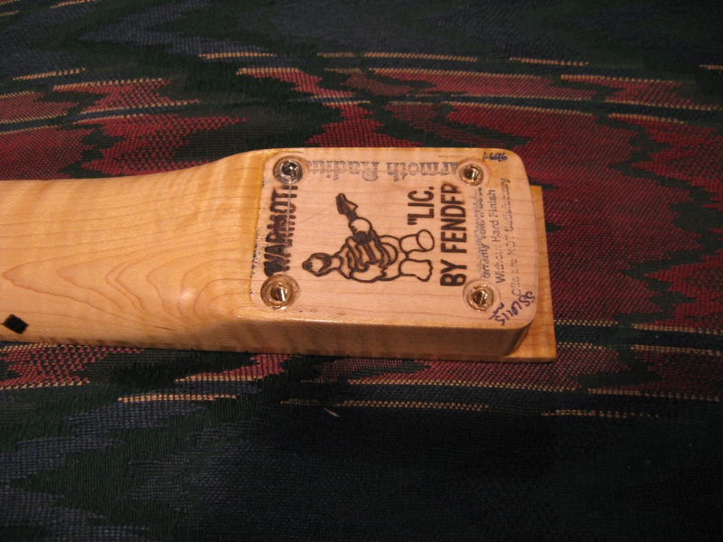

Behlen's "Master Gel" is a water white poly finish, but any finish you put on wood is going to change its shade to some degree. For instance, this is Mahogany with a wipe of Naphtha on it...
30 seconds later, that darker area was the same color as the lighter area again as the solvent boiled off. That's pretty dramatic - not all woods will change that much. For instance, this is a Maple neck that's been finished with Behlen's Master Gel...
As you can see, even "clear" finishes will tint to some degree.
It's pretty much the same job either way, although you wouldn't put as many coats of the gel on. The gel is also a much more robust finish than Tru-Oil, so that's the route I would take. Tru-Oil doesn't stand up to much of anything. Water, alcohol, sweat, etc. will eat into it, and it's also a softer material that will scratch/scuff/wear faster. On the plus side, it's easier to repair if you're so inclined. Polyurethane stands up to all those insults quite well, but if you do manage to break the finish somehow, it's very difficult to repair.
