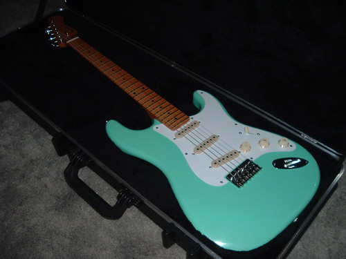

Just finished my first build with a Warmoth hardtail strat body.
Now that looks like my kind of strat! :icon_thumright:
what kind of pickups did you use?
The pickups are Keystones from Bill Lawrence. Haven't set it up yet so I don't no the full potential. So far they are rich sounding & very quiet.
Wish it was a lefty :icon_biggrin: :icon_biggrin: :icon_biggrin: :icon_biggrin: :icon_biggrin: :icon_biggrin: :icon_biggrin: :icon_biggrin: :icon_biggrin: :headbang:

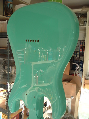

riverbluff said:
Excellent build.  How did you do the finish?
I got the paint from Reranch and pretty much followed their directions. After clear I wet-sanded with 1000, 1200, 1500 & 2000 grit. Followed that up with Meguiar's Scratch-X and then 3M Finesse-it II.

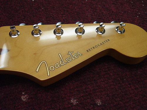

Q: Where did you get the logo transfer made up?
OzziePete said:
Lovely looking Strat there! :glasses10:
I ordered it from Ebay, sellers name is brauskoh. He made it to my specs.
