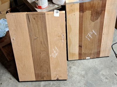

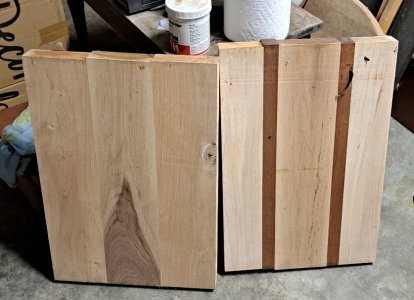

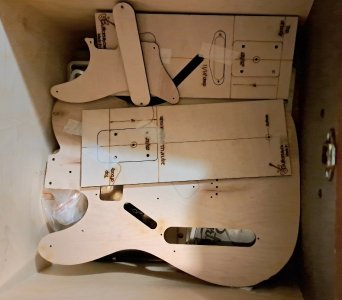

I have a couple of blanks and a tele template, but I don't have a router, I don't have any other use so I will get a cheap harbor freight. I want corded but don't know if I need 1/4", 1/2", plunge base, etc... will be my first and only router

Thanks for all the advice, I decided on getting rid of the blanks and keeping my fingers, just seems cheaper for me in the long run.

The templates in your post are the same ones I use, from GitrBuilder on eBay. I have quite a collection of his products :) I suggest, as part of router practice before laying a bit to a real stock piece like those pretty blanks, is to make copies of those templates on sheets of MDF. MDF won't kick back or be subject to tear-out like real wood will, and if there's anything that's a confidence killer in your beginning stages of routing, it's tear-out.
And that'll also save your original templates in case of accidents or just use over time. I've used my Tele template so much but didn't make a copy of it that it's wearing out. Plus I also misjudged bit depth once when using it to route the control cavity that the collet on the router came into contact with the template itself and started burning a channel through it.
