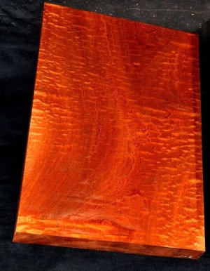

+1 on the neck being the biggest influence on tone .  Finding a billet of rosewood is rare , and I look for such things every week .  Another alternative is sapele , it can be quite gorgeous and has nice tone as well .  It is heavier than mahogany , similar to walnut in density .
