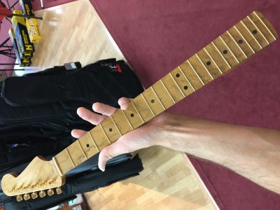

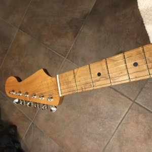

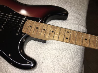

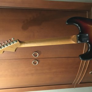

I wish I had saved pics of the body from the showcase but I was too anxious to buy it before it was scooped up (I usually don't see something that's exactly what I'd order for a build idea, not to mention extra light one-piece). But I'll post pics when it gets here in probably a couple weeks. Already got the roasted neck... pics below:
I ordered this roasted maple neck in 2020, only when I couldn't get the specs I wanted from Warmoth, and the plan was to eventually do a Guthrie tribute with it. Obviously not a complete replica..
MK neck specs:
24-3/4" conversion scale
single action truss
22 Evo 9055 frets
10” radius
.87-.97" C profile (very comfy, similar to Warmoth '59 Roundback)
1.65" nut width (Graphtech)
oil finish
Kluson tuners will be swapped for Gotoh locking vintage style
