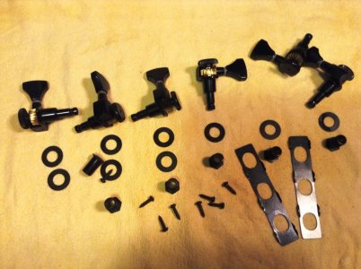

Here are the parts out of the box.  They gave me extra screws and washers.  I assembled them before putting them into the neck and found that one of the UMP trays, the things with the three holes, had flanges that were too tight, so tonight I'm going to gently ever so much bend them to the point where the tuners will fit snugly between them.  Probably use two needle nose pliers with tips wrapped in chamois. After I get them installed, I'll move the rest of my progress over to the work in progress section.

The UMP fit as I recall was quite snug but I didn't have to bend anything.Of course your up close to the parts.
Just a little ever so slight bending and they fit nice and snug.  Next step will be mounting them on the neck.  I'm already thinking of swapping the tuning buttons to something else.  Imperials wouldn't work, too big ... since it's going on a tele deluxe I'm thinking maybe something keystoney.  It would give it nice retro look.

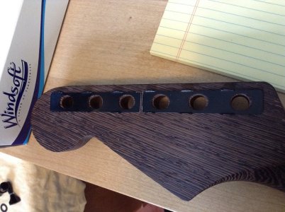

I put the tuners on, just finger tight and found that the UMPs overlapped.  According to the directions, on a standard fender spaced neck they should've just touched.  The directions said to contact hipshot if they overlap and they'll send me for free a special UMP, or I could file them.  I opted to file them.
here they are filed.  Came out good.
I didn't force them tight, just to point of full snuggness.

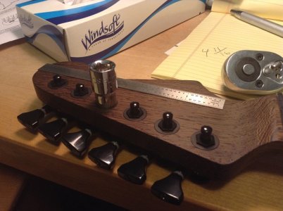

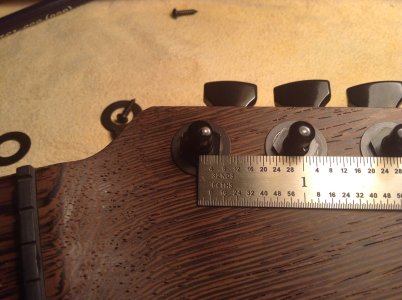

after the problem with the f style tuners and having to file the UMPs I checked to see if the holes on the warmoth neck were standard spaced.  Indeed they were a almost perfect 4 11/16's inches from the center of hole one to hole six, just look for yourself.  It's mighty close!
You'll note a little bit of paint scraping in the big picture on the tuner nuts.  I suppose if microscopic paint scraping bothers you, don't get the black ones, stick with the chrome.  The nuts seem to be electroplated black, and the washers painted.
Another thing, you can see that wenge is a really interesting wood, large pores, naturally oily, interesting color  I cannot wait to play it.  It's a hard wood, and the large long pores will have a natural chambered effect.  A chambered neck, no wonder bass players love this wood.
