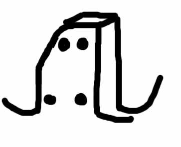

ive seen this neck heel. It is different enough, like the old 70's 3 bolt heel, that i dont think they'd be able to make you a neck for it without a giant upcharge.
here is my 3rd gradesqu drawing of what i think you are talking about
