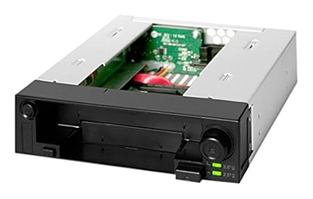

Speaking of removable bays, check this little lovely out...
It's an ICY DOCK DuoSwap MB971SP-B 5.25 Inch Hot Swap Drive Caddy / Docking for 2.5 Inch & 3.5 Inch SATA Hard Drive/SSD.  Bolts right into a 5" bay. I've used a lotta removable drives in the past, but this one's the best. Does 2.5" and 3.5" drives both, and at the same time. Plus, you get power and activity indicators for both, and you can turn the drives on/off individually from the front face. Power 'em right down, so no spin, no heat, no wear. Very cool feature. I'm gonna stuff a huge HDD in the 3.5" slot, and that's what I'll use for backup.

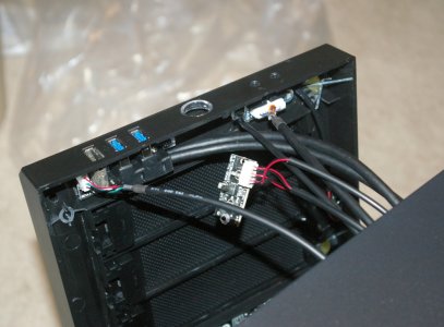

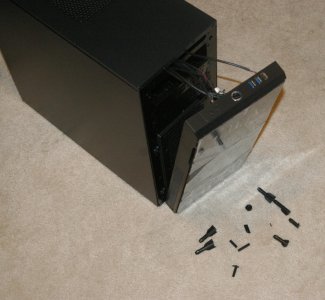

Nanoxia Deep Silence 3 arrived. Beautiful case. Very well damped. But every single plastic part that holds the front on was busted. This after the last thing I ordered off Ebay (different seller - this was via an actual dealer on Amazon) also got screwed up. I ordered a mixer rack/stand and they sent me a 25lb box of casters and bolts and wouldn't take it back until I got Ebay involved, then they wanted me to revise my negative feedback.  :tard:
Anyway - I REALLY hope they can send me the busted part and not have to box another dang thing back up and send it back. Yeah, I have the original box, just opened it. Yeah, they pay shipping on RMA, but dangit I just want to put the puter in the new case already. Sent me the plastic only and avoid shipping a 20lb computer case (cause it is a heavy one) two more times.

That's a shame. Wait and wait, then... denied!
What's funny is if you read a lotta case reviews, you'll invariably see in the comments somebody complaining that the reviewer spent 2 or 3 paragraphs talking about unboxing the thing, as if it was a waste of time talking about non-technical details. Thing is, what happened to you happens too often, usually with packaging that isn't UPS-proof. Knowing that sort of thing on the going-in side can save you some grief.
For example, not too long ago I bought one of those Black & Decker Shopmate folding benches, and from nearly every seller there was at least one reviewer who complained about missing/broken parts due to poor packaging. Knowing that, I ordered one for pickup rather than delivery, and it was a good thing I did. Got there, and the one they pulled for me looked like it had been used for artillery practice. So, I made the guy go find me one that didn't look like it had been run over by a tank.

Forgot to follow up - they got me a new front plastic, super customer service from Eagle Tech USA (Amazon seller). They made it right immediately without even having to get Amazon involved.
It's quiet, and spacious and nice cable routing. The green LED ring on the power button is stupidly bright - that's about my only complaint. I might unhook it (and the power button) as it only begs my kiddo to turn my computer off and on.
