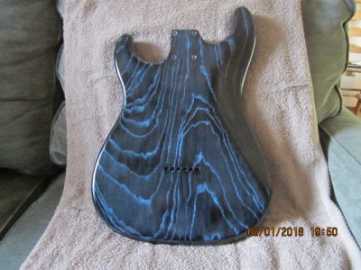

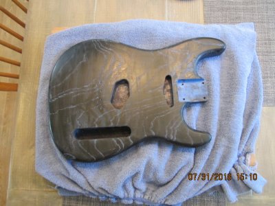

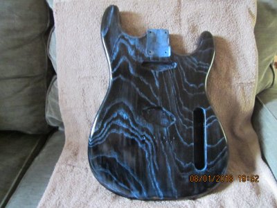

FWIW, here's what it's looking like now:

That is looking quite good now.

I don't have anything helpful to add regarding the filler / sealer stuff (I've only ever finished alder, which doesn't require grain filler), but I'd like to say I like the look you've got now, even if it's not what you were aiming at.  It looks almost like marbelized wood!  :icon_thumright:

A kinda weird thing shows in these newest photos. After I dyed the body black, then stained with Ebony stain, I brushed on 2 coats of clear Zissner's Bulles Eye Shellac. This shellac was tinted with blue Transtint dye. Now, I could not see the blue tint when the shellac was "glossy". It seemed like it may have made my black a tiny boit darker,  maybe.....
But when I was sanding the grain filler with my last grain fill attempt, the blue in the dye became visible in places, some more than others. You can see some of that in these photos with the coat of clear gloss poly over it.......

Looks good! I like that effect.
