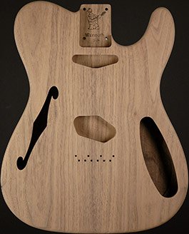

Walnut doesn't really need a finish, if you want to stain it a little darker, go ahead would suggest Minwax Dark Walnut, then just apply WATCO Danish Oil once in a while. This walnut Strat I did was finished that way, was just a tad darker "raw" than in the Showcase picture of the one you're going to order:
http://www.unofficialwarmoth.com/index.php?topic=234.0
If you intend to tung oil it, it will take a real long time to build up enough coats to fill the grain in walnut to get a smooth gloss finish. Or do you intend to do a fill with clear grain filler?

Walnut has a very tight grain, but isn't "smooth", i.e., there are lots of very fine grain lines in the wood that aren't very deep. If you want "nice semi-gloss finish with prominent grain" the easiest thing is just to stain it to the desired hue and apply WATCO Danish Oil. WATCO Danish Oil is NOT a finish like tung or Tru oil, more like an oil furniture polish than any type of hard finish.
If you don't like that, then you can always grain fill and top off with tung oil finish.
You can find WATCO Danish Oil at most Ace/TruValue hardware stores/"Danish" furniture store chains and lots of other locations, don't recommend anything but the WATCO, have heard there are other products labeled "Danish Oil" that are more like a tung oil product.
