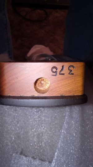

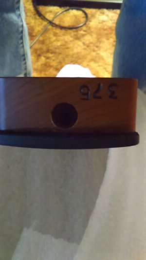

Question about my new warmoth neck?? huge hole in the heel on a vintage/modern?
rolteus
2
I just received my new Roasted Maple and Rosewood vintage modern neck and I think I have a problem. It's an adjust at the headstock design but appears to also have the empty hole for the heel adjust. It's almost as if they drilled it for a heel adjust then changed their mind. Can anyone tell me anything about this or did I get a bum neck from warmoth? If this is how it's supposed to be it's ridiculous. If it's a mistake I can't understand how it made it all the way to finish without anyone noticing it but I suppose it's possible??? Please don't tell me that's how they make them...
It's an index hole. That's how Vintage/Modern necks are made.
Sorry, but yea - that's how they make them.  It's an index hole for the CNC machine for the Vintage/Modern necks.  Other necks (Vintage or Pro) don't have it.
