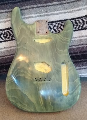

I think I've done something kinda similar to what you're attempting. Can maybe provide pics tomorrow. I used light blue enamel paint all over a roasted swamp ash body & scuffed that to the point where the paint got sorta "thin/opaque-ish". Mixed up some craft store water-base paints with white & silver colors, then put that in some thinned white Timbermate, and used that for the first grain fill. Then filled the remaining voids & low spots with a clear water based grain filler ("Aqua Coat" I think; I forget what it's called.......  :icon_scratch:). It came out nice,  up to that point.
But for a top coat, I used an aerosol oil-based poly from Minwax ( Silver can, gloss, 'cause that's how I roll......). Ordinarily not a totally bad call, but it really yellowed the light blue and especially the silver/white grain fill. I think maybe water-base poly would have preserved the color I wanted to keep, and probably would be more scratch resistant. Will try to get a pic tomorrow.
Here's a pic of what I tried to describe above. This poor Hybrid got used for multiple finishing experiments, most of which failed.  :sad1:
Notice the white paint in the pickup and control routes (from an earlier failed "experiment"  :sad: ). It yellowed a lot, after somewhere around 3-4 months or so, and just seems to have gotten worse till around the 8 month point. Ditto for my white &  silver grain fill, but that may not show as dramatically as the white paint in the routes.
This was an effort to get a faded denim/ceruse sorta effect.
