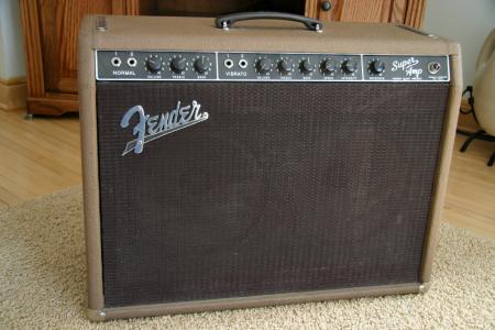

You talking about one of these? What vintage? Last service?

That appears to be a mainly stock early '70's Super Reverb.
If memory serves, there are 4 screws going through the top of that amp holding the chassis in place; the pic CB was talking about involves removing those and pulling the chassis to take a shot of it from the bottom, the opposite side from where the tubes insert.
