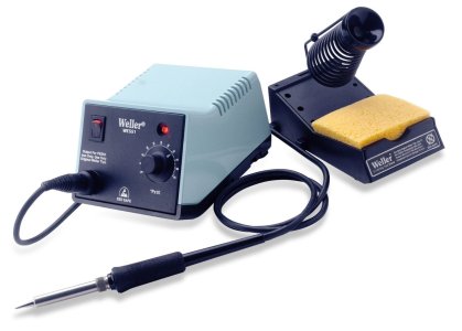

I've got a cheapo, and I hate it.  I'm looking to replace.  I'm eyeing the Weller WES51 as a more versatile, die-hard type machine, but I thought I would weigh in with you guys and see if you have an iron of choice, and why you chose it.  I'm sure this has been discussed before, but I'll be damned if I can find anything.

I have two irons, both pencil-type. One is a 5-40 watt Weller adjustable/isolated soldering station, and the other is good old-fashioned 50 watt American Beauty. The Weller is fancier than I need for guitar work. I don't ever adjust it down, and I don't need isolation. The main reason I bought it is because 40 watts is about right and it comes with a built-in stand for the iron, as well as an on/off switch. Plus, it was on sale ridiculously cheap so I couldn't say no.

So, basically the adjustable temp isn't really needed.  Better to buy high quality?

And no, the adjustable heat isn't necessary. I think that's more of a gimmick than anything else. You have to get up to 400 degrees to melt solder whether you like it or not, so what are you adjusting? And there's nothing in a guitar that's static sensitive, so isolation isn't an issue. If you were working on PC boards loaded with TTL chips, SM devices or something like that, then I could see getting a bit fancy. But otherwise, the American Beauty is the thing to have.

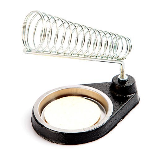

One thing I need to do now is find a stand, as the one that ships with the iron is a joke, and the iron doesn't fit into the one that I have currently.

It's tough to find a good heavy duty stand. I like the design of this one...
...it's priced well and I may end up ordering one to replace what I have, but I need to find a way to add some weight to it. It's only 12 oz., which to me is too light. Probably wouldn't get knocked over easily due to its footprint, but I could see it moving around the benchtop in normal use. Plus, that American Beauty has a fairly heavy duty cord on it, so the typical springy stands tend to be a bit saggy under the weight. Don't want something sitting at 700+ degrees to be anything but well-placed.

Load it up with solder and there's plenty of weight there.  Not a bad find.  The new iron doesn't even fit through the opening of my current stand, I'm not sure that one has a larger opening?  "Holds most pencil style soldering irons" is what they have to say.
Yeah, I was trying to think if there would be a sagging or positioning problem with something like this:
