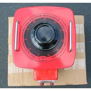

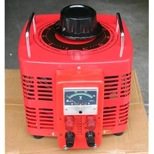

Could you point me to a page with the variacs on it? I could do a search, I did actually, but there were so many variations that I had no idea what I was looking at. If you could point me to a specific model that would be even better.
MULLY
http://www.amazon.com/Mastech-VARIABLE-TRANSFORMER-VARIAC-5000VA/dp/B000E0G7O4/ref=sr_1_1?ie=UTF8&s=hi&qid=1277094233&sr=1-1
That will do - big enough to run a pair of 100w amps if need be!~
