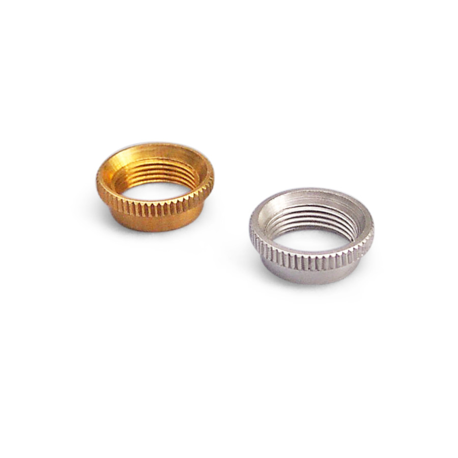

You're using the terms "switch" and "pot" interchangeably, and they're quite different parts with different attachment methods. If it's a switch, what kind is it? Some switches are attached with screws that feed through the top from the top (common on Strat or Tele styles bodies). If that's the case, you may just need longer screws. If it's the toggle type of switch such as is used on Gibsons, sometimes you need a recessed barrel-type nut to hold it on, as the threads won't make it through to the top. Not supposed to. They look like this...
...and can be had from someplace like this.

Only problem with those nuts is you sorta hafta have one of these tools...
You can get away with trying to use a pliers or something, and that'll work, but the chances of wrecking your finish (or the nut) are quite high. But, the tool isn't terribly expensive unless you consider you'll never use it for anything else. On the other hand, what's $18 to save a $300 finish? It's cheap insurance and returns professional results.
